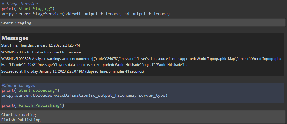

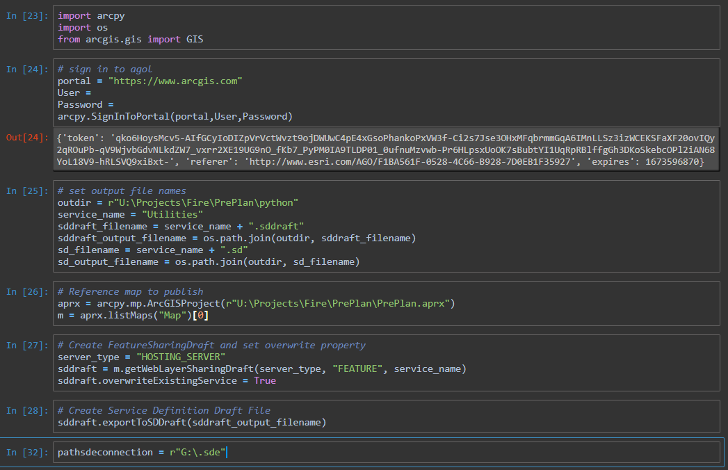

I had originally posted a group layer from Pro (in an sde) to AGOL
    - I guess my first question is can I overwrite that group layer or do I need to create 11 separate hosted feature layers?
I am trying to write a code that will automatically update these layers in AGOL. I haven't used code before this, so every time I read a document I get a but more puzzled. Wondering if anyone could help me out with these errors? How/where do I need to connect to the server?
I am following: https://pro.arcgis.com/en/pro-app/latest/arcpy/sharing/featuresharingdraft-class.htm

 In terms of the geoaccessor.from_featureclass (path) --> would I have to do this for each layer individually and split my utilities group layer up or can I just use a comma to separate a path to the 11 different utilities under my utility layer in my map?
