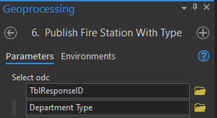

Hello everyone, I'm working on creating a tool that will allow me to select multiple tables from an Access Database and convert them to standalone tables in a Geodatabase:
I created a .odc database connection to the Access database the tables are being stored in hopes to make it easier to select the tables.  Here is the script that I have so far:

ColeNelson
Hi Don I copied and pasted the wrong thing lol
File "C:\UpdateDevelopmentPython\DevelopmentScripts\PublishFireStationWithType.py", line 13, in <module>
Tbls = arcpy.TableToTable_conversion(tables,outpath,["baseName"])
