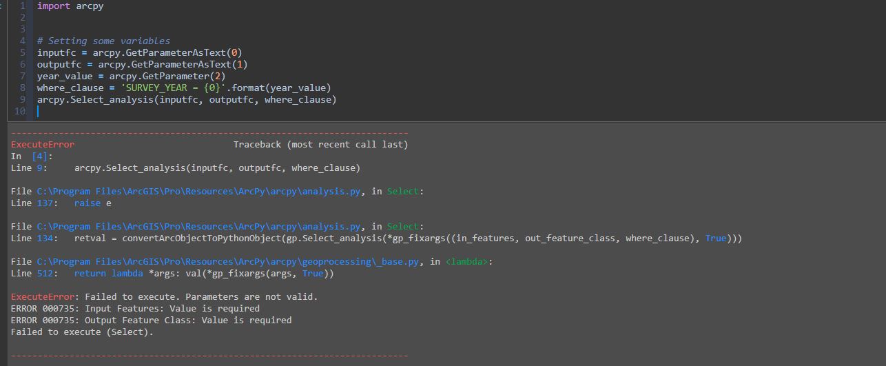

Edit: here's a screenshot of the error message

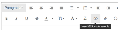

Markdown doesn't work here. To format code:
Can you post a screenshot of the error message? That way, we can try to backtrack to where your script fails.
Does your inputfc really have a field called SURVEY_YEAR, and is that field really an integer field?

Thank you. I changed some things around to make it easier to read/work with. Also, yes, the inputfc (the input feature chosen that I am working with) does have a field called SURVEY_YEAR, and that field contains short-numeric int values.
