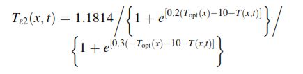

Xander Bakker I am running into a problem of the mathematical expression in raster calculation. Earlier we had worked for writing the below code. According to existing mathematical function in the script, if raster cell value will be
Earlier we had worked for writing the below code. According to existing mathematical function in the script, if the raster cell value (Mean raster in script ) will be increase or cross the threshold value (23 mentioned in script) , output raster cell should be decreased . But with this code, I am getting reverse output which is not desirable. I have checked the same mathematical equation in Arc GIS raster calculator and Excel also, both results are same.  But Output  generated from below script is not matching with Excel and Arc GIS raster calculator's result . Kindly provide your guidance to solve the issue .
Below I have attached the link for raster data, which I am working on. Due to size limit here, I just uploaded on dropbox.
I am using Arc GIS 10.3 and script running on PyScripter
In below  equation Topt = 23 which is constant value (in our script) and T = Monthly mean raster data which is changed monthly.
Data link : Dropbox - TEST_TSCALAR1.rar
Script copied from Arc GIS raster result :
arcpy.gp.RasterCalculator_sa("""(1.185 / (1 + Exp(0.2 * (23 - 10 - "Mean_Temp_010.tif"))) / (1 + Exp(0.3 * ( - 23 - 10  + "Mean_Temp_010.tif")))) * 0.99""", "D:/NPP_GUJARAT/WEATHER_DATA/2012/T_SCALAR_2012C/T_SCALAR_010A.tif")

            # I devided the above equation into two part
            # TScalar2 (Exp = exponential)
            ras_scal2 = 1.1814 / (1 + Exp(0.2 * (23 - 10 - ras_mean)))
            # TScalar3
            ras_scal3 = (1 + Exp(0.3 * (- 23  - 10 - ras_mean)))
            # Multiply TScalar1 and TScalar2
            ras_scal = 0.99 * (ras_scal2 / ras_scal3)

In your first code snippet, the last part of your equation is  -meantemp, you have +meantemp which disagrees with the equation symbols... Which is it? A minus here, a plus there, will make a difference

ShouvikJha
Dan Patterson‌, Thank you very much. Exactly you hit the source of error. Sorry for
Xander Bakker  Sorry for the inconvenience.
Main reason for error is:
1. During script writing, i followed the wrong equation (Snapshot) which is published by co-research author.
2. During Arc GIS raster calculator i followed the right equation which is published by main research author.
 I figured out the error with the snapshot equation after Dan Patterson pointed the minus and plus difference. And i checked the main research paper also from where  co-author has taken the equation.
And which equation i used in Arc GIS raster calculator and Excel sheet that is  correct, that's why i was continuous getting the wrong result.
Now i am getting the accurate result from both of programs.
