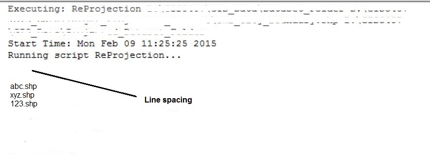

This is a visual of what I am trying to achieve;

as I said
arcpy.AddMessage("")
will produce a blank line
MarkWisniewski
Deactivated User
No change

DanPatterson_Retired
MVP Emeritus
last try and then this is going into my collection...
arcpy.AddMessage("\n")
otherwise post your code
MarkWisniewski
Deactivated User
Its not going into your collection . That worked putting arcpy.AddMessage("\n") at the start of my script. Thanks for your patience Dan.
