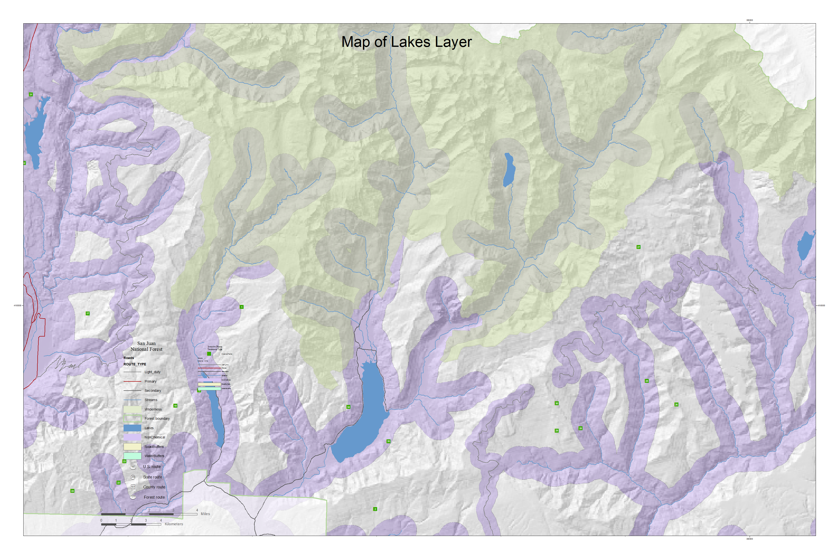

This is the exported image after running in ArcMap Python window. Looks ok.

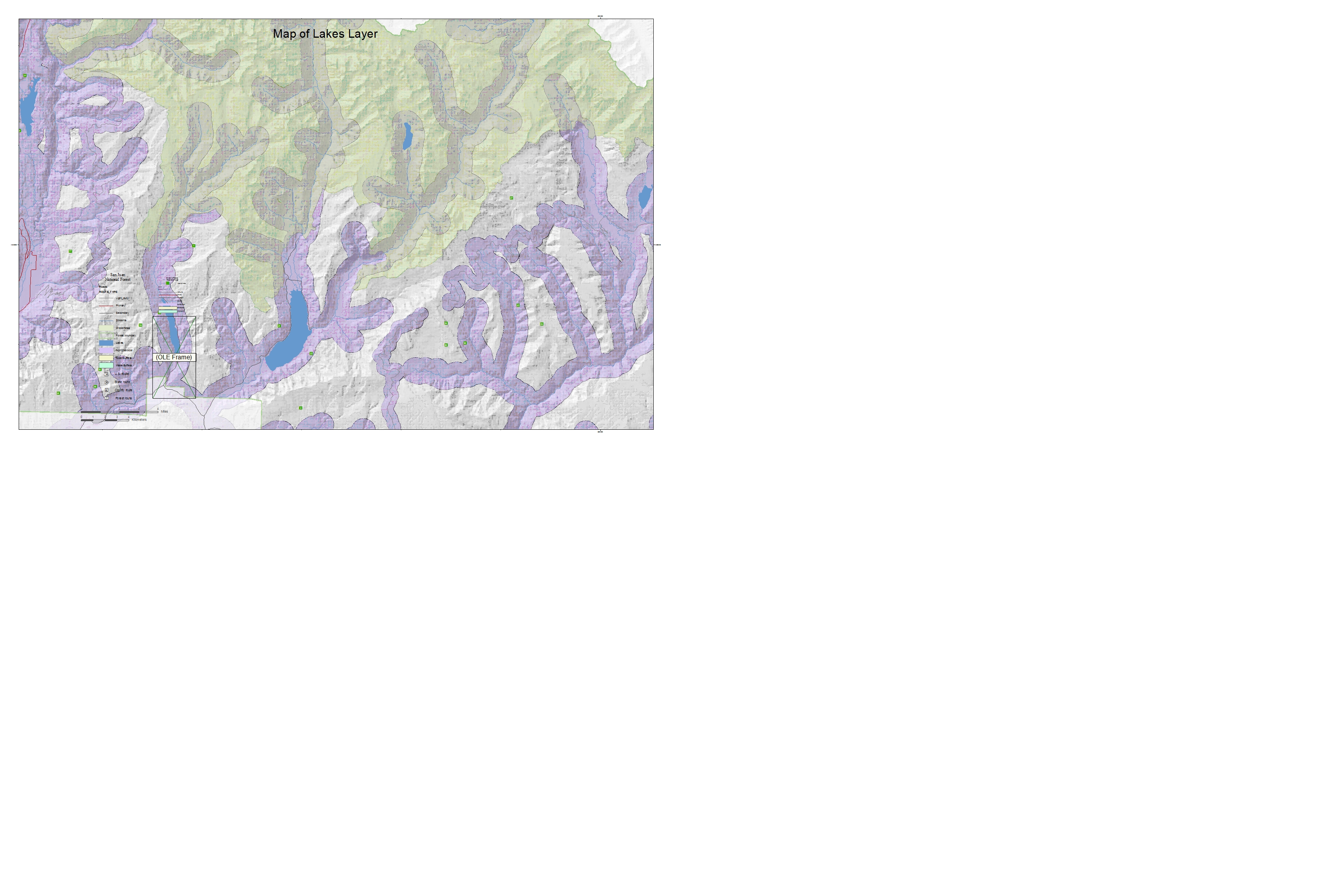

This is the exported image after running outside of ArcMap. The image only fills up 1/4 of the whole image frame.
What could be wrong?

When altering between inside / outside of ArcMAP, can you confirm you just change the line of code:
mxd = arcpy.mapping.MapDocument(mxdLocation)
to
mxd = arcpy.mapping.MapDocument("CURRENT")
and everything else remains the same?
Kah_SiongTan
Deactivated User
Hi Luke,
There are no changes in codes when i alter between inside/outside of ArcMap. Both are as follows.
mxdLocation=r"c:\myfolder\mymap.mxd"
