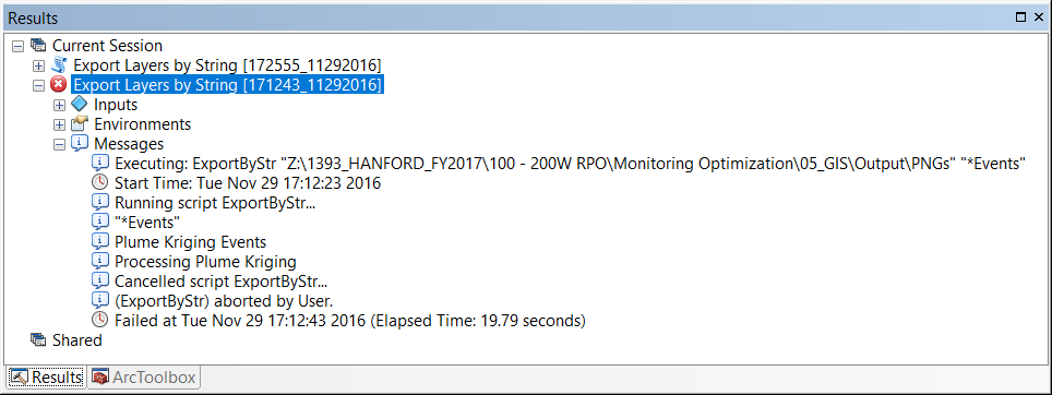

I have a very simple program to toggle on and off layers and export PNGs. The issue is trying to pass a string to search for in the ListLayers result.
If I pass the parameter with the tool dialog, I get no return, even though I AddMessage the string and it shows as expected (see the 4th line under Messages).
If I hardcode the string on line 27:
     for lyr in arcpy.mapping.ListLayers(mxd, "*Events", df):
, no troubles.
I expect I am missing something basic in the interpolation of the passed string, but I have tried enclosing in additional quotes and using escapes before the quotes, to no avail.

Have you tried passing just *Events, no quotes.  Since the parameter is defined as String, whatever you are passing is already being interpreted as a string.  I would have to double check, but I believe quotes in string parameters are escaped to be treated as literal single or double quotes, which isn't what you want because you don't have literal quotes in your layer names.

JimCousins

That was my original thought as well. I have just tried:
SearchStr = arcpy.GetParameterAsText(1)
SearchStr = '"{}"'.format(SearchStr)
No luck
Tried:
SearchStr = '"'+str(SearchStr)+'"'
No luck
The parameter is set to a string type in the dialog.
Actually at a bit of a loss for what else to try.

That is a good thought, Joshua. I had tried that as well as using single quotes, double quotes, escaped quotes (/', \', " ' ", ' " ') No joy yet. I have submitted a support ticket to ESRI, and will let you all know what shakes out.

I have restarted my machine and it runs successfully now. I have no idea why it was failing previously, as I can look at the Geoprocessing Results tab, and see the same arguments entered with an unsuccessful result as what I have used for a successful result today. The entry for the string does not need any quotes, as Joshua surmised. ESRI support ran my code as provided with no troubles, I tried it on a different machine with no troubles, and then tried it again on mine with success. No idea what was preventing it before. Thanks to all for your help and input.
