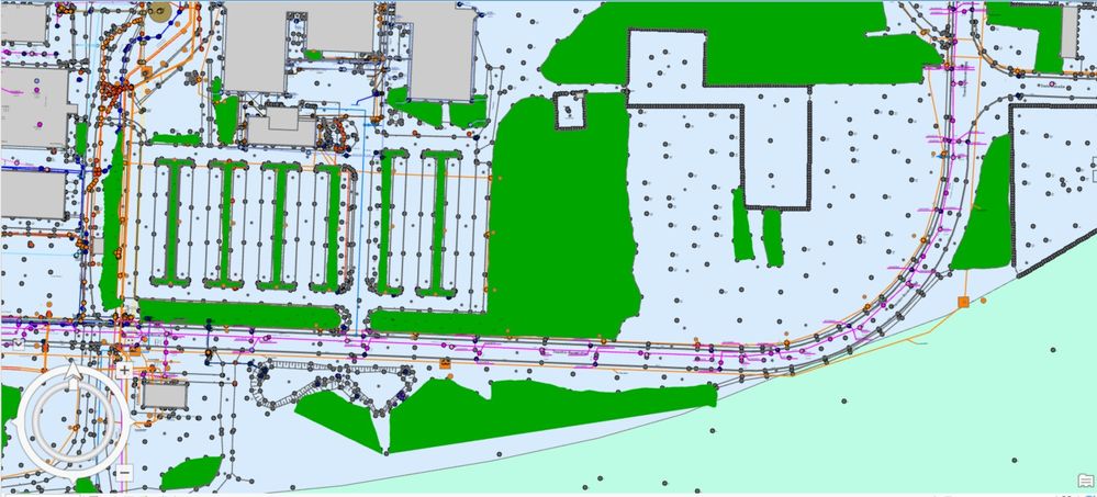

1. Before running the script, the map looks like this:

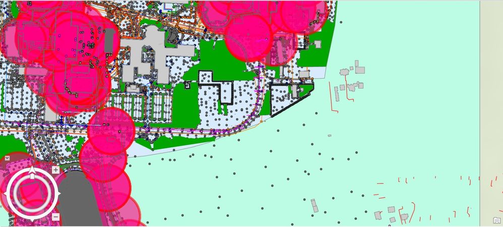

2. For testing purposes, I alter the symbology for a point data layer such that the symbols are huge (and also have a very noticeable color):
02_after run script_same zoom level.jpg02_after run script_same zoom level.jpg
3. When zooming out, the symbols are scaled and consequently cover a lot more area in "real world units":
03_after run script_different zoom level.jpg03_after run script_different zoom level.jpg
