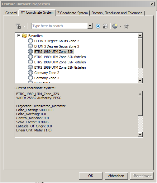

So I have a workable sollution to this based on everyone's feedback (see code below).  The only nagging issue is that when I run recursiveDatasets in main() after redefining all feature classes and datasets, when I print spatialReference.name, it's still printing the old spatial reference  I checked the SR in ArcCatalog for each FC and FD, and they have indeed been redefined:
So why is it still printing the old SR?  Is that output being drawn from a different parameter than that being displayed in the XY Coordinate System tab?  I have also tried refreshing the geodatabase following the redefinition, but that makes no difference.

I have the same problem.  The dataset and feature classes seem to be changed, but the desc.spatialReference.name ist still named as the old spatial reference.
After copying the dataset in a new geodatabase, the desc.spatialReference.name ist correct and consistent.
Is there a solution/workround (without copying)?
