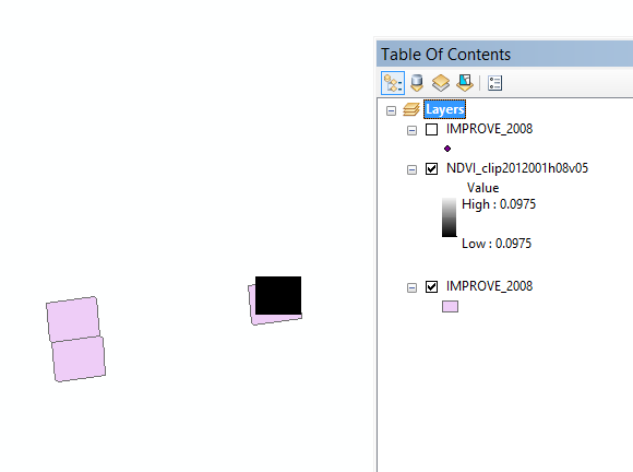

And the output looks like this:

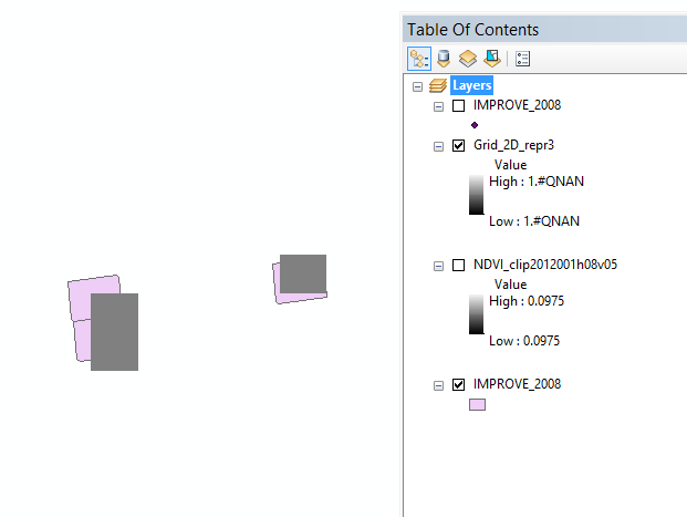

But if I don't use the Python.
The output is looks like this:
Why there are two grids missing by using the Python?

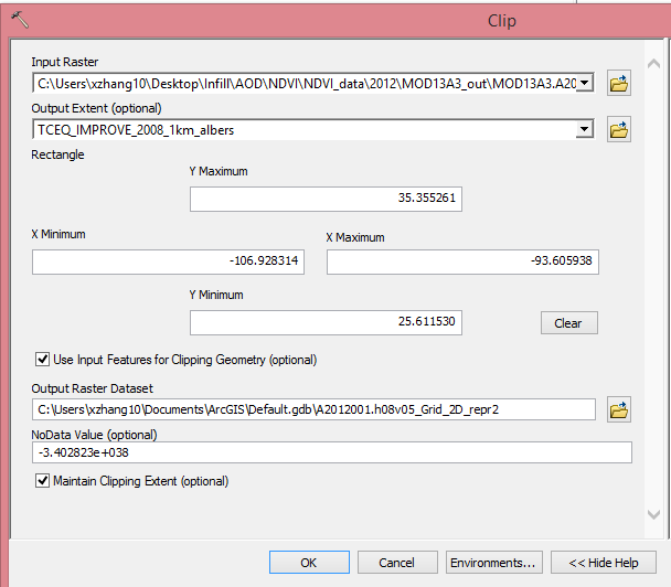

note clear in the first image you set the extent to decimal degree coordinates, but you are using an albers (projected) file.  Can you confirm the extents in both files as to whether were selected from the layer or typed in and whether in file being clipped has the same coordinates as the clipping file
PS I would check the effect of the checkbox ... maintain clipping extent

If the tools and inputs are the same but outputs are different, I suggest investigating if the environment settings in ArcMap and in the script environment are script are different. Especially check processing extent, output coordinate system, mask.
AndrewKeith3
Set your Rectangle variable to "#".  You don't need to specify an envelope if you are providing a shp as the clipping extent.
Rectangle = "#"
