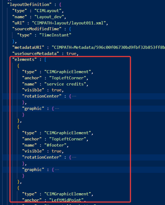

Hi All,
Looking for recommended approaches to reorder layout elements in the Contents sidebar using ArcPy CIM. I'm assuming that I can just move elements around by their list index in the Layout definition?
Tags (3)
JohannesLindner
MVP Alum
Yes.
This script reverses the order of layout elements in the content pane and in the layout itself:
layout = arcpy.mp.ArcGISProject("current").listLayouts()[0]
cim = layout.getDefinition('V2')
print([e.name for e in cim.elements])  # layout elements from bottom to top
#['Map Frame', 'Scale Bar', 'North Arrow', 'Map Frame 1', 'Table Frame']
cim.elements.reverse()
#['Table Frame', 'Map Frame 1', 'North Arrow', 'Scale Bar', 'Map Frame']
layout.setDefinition(cim)
