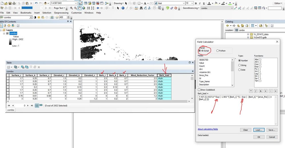

SalahuddinAhmad
exp.JPGThanks, @curtvprice for your help.
Yes, it is a raster dataset name "combo" and those are the field names from the raster table. I trying to calculate a field called "Bark_load" based on the following equation.
VB
7.437 /(1+937.8 * Exp ( -1.905 *( Bark_r *(1 - Exp ( - Bark_k * since_fire ) )+ Bark_c )))
Python
7.437 /(1+937.8 * math.exp(-1.905 *( !Bark_r! *(1 - math.exp(- !Bark_k! * !Since_Fire! )) + !Bark_c! )))
please note: exp is exponential function not Exp (Spatial Analyst)
I have a modelbuilder and this equation works there as VB and Python.
Thanks for any further help.
curtvprice
MVP Alum
Here is how that works with the tool:
inTable = "C:/Data/A3_Large_projects/Fuelloadmodels/Data/GDB/Yr2021.gdb/combo"
fieldName = "Bark_load"
expr = "t_RF(!Bark_r!, !Bark_k, !Bark_c!, !since_fire!)"
cblock = """
def t_RF(rr, kk, cc, sfire):
    import math
    if sfire >= 0:
        return (
            7.437 /
                ( 1 + 937.8 * math.exp(-1.905 *
                    (rr * (1 - math.exp(-kk * sfire)) + cc )))
    else:
        return 999 """
arcpy.CalculateField_management(inTable, fieldName, expr, "PYTHON_9.3", cblock)
