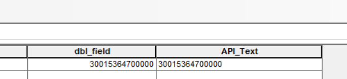

I just tested your code using the interactive Python window in ArcCatalog 10.6.1, and the results are as expected for both a feature class table and DBF table:
