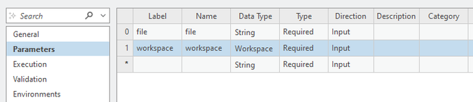

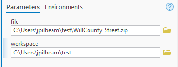

Thanks, that works on its own (without += operator) but embedded in the script tool with the same input as before it runs but doesn't delete and no print statements in tool.
I believe the issue lies with the script tool data type parameter for file. I'm going to concentrate on that.
Tool interface:

It worked with the arcpy.GetParameter() function and the Data Type parameter set to String. I used the index 0. I was able to run the tool numerous times on the following files and it deleted all of them: *.zip, *.shp, *.png, *.jpeg. So:

I was just getting ready to indicate the parameter 0 has to be GetParameterAsText and as to be string.  I tested it on my end.
JaredPilbeam2
MVP Alum
Nice. Yeah, it doesn't make a difference if parameter 0 is GetParameter() or GetParameterAsText(). Both work. It's only the Data Type that needed changed.
