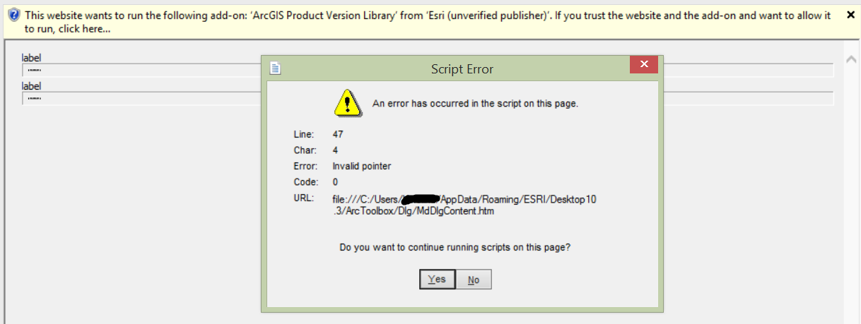

I have built an ArcGIS toolbox for ArcMap 10.3. The tool works fine. However, sometimes I am receiving an error (attached below) and to enable the use of the toolbox I have to restart ArcMap and import the toolbox again. I do not know what is wrong in line 47 in the script - which is according to the message responsible for the error, because when I added few additional lines in the code the error still appear in line 47 (doesn't matter what is in this line). Does anyone know what should I do to correct this error?

The error isn't in your script...it is in the script that is trying to do something with your toolbox.  So there may be an error in your script which invokes this error and it is your script that needs to be examined.

I already checked my script several times, and I do not see anything what could invoked this error. But I realized that the error occurs after I click on my toolbox and open "Item Description" - then something in ArcMap changes, the Fonts are bigger and blurred, see the imaged attached below. After the error I cannot any toolbox (not only mine). Can it occurs because of my script?

From the link below it seems that this error occurs due to the Internet Explorer security settings, and in more detail "Allow previously unused ActiveX controls to run without prompt" https://gisnuts.com/terra/blog/2013/01/22/arcgis-geoprocessing-tools-scripting-error

If the above solution (Allow previously unused ActiveX controls to run without prompt) doesn't work, try resetting your ArcGIS Application profile.
Resetting your ArcGIS application profile
