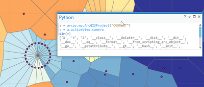

In ArcGIS Pro 2.8, this code works in a Python window but not in a notebook.
a = arcpy.mp.ArcGISProject("CURRENT")
v = a.activeView.camera
AttributeError                            Traceback (most recent call last)
In  [25]:
Line 2:     v = a.activeView.camera
AttributeError: 'NoneType' object has no attribute 'camera'
