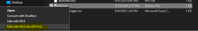

I upgraded Pro from 2.5 to Pro 2.6 , I have some *.py files that I want to edit / run. right now I am not planning to install any IDE so I am trying to use ArcGIS Pro IDE do the job.
now when I try to import arcpy in my script I get the following error:
