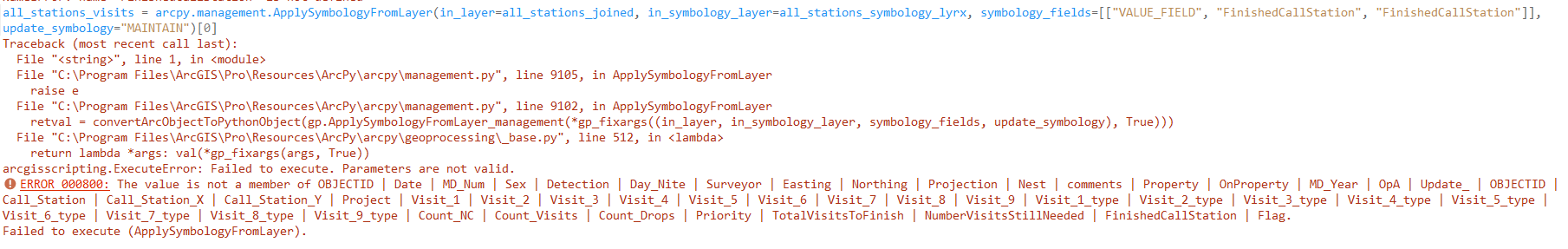

The attached photo and below script shows the line of code that I am getting an error with. I am trying to run arcpy.management.ApplySymbologyFromLayer in arcpy. And am getting an error saying that "the value is not a member of " my shapefile. The name of the column I want to use to symbolize is "FinishedCallStation" for both the layer file and the shapefile. The error message shows that the column exists in my shapefile, so I don't know why I keep getting the 000800 error.
Below are 3 iterations of this line of code I've tried, but am getting the same "value is not a member" error for.
Version 1:
all_stations_visits = arcpy.management.ApplySymbologyFromLayer(in_layer=all_stations_joined, in_symbology_layer=all_stations_symbology_lyrx, symbology_fields=[["VALUE_FIELD", "FinishedCallStation", "FinishedCallStation"]], update_symbology="MAINTAIN")[0]

I realized that the visibility for the field I was trying to use to symbolize the feature layer. So I had turned the visibility off for all_stations_joined.FinishedCallStation in the ArcPro attribute table and I guess that also impacted arcpy.

Did you try a simpler variant
... ("all_stations_joined", "all_stations_symbology_lyrx",  [["VALUE_FIELD", "#", "FinishedCallStation"]] ...
And the full paths to the inputs should be defined as variables.

Hi Dan, thanks for the suggestion. I tried simplifying but I'm getting the same error. Also my arguments are being read in as paths, see below:
All_Call_Stations_gdb= path to my gdb
all_stations_joined = All_Call_Stations_gdb + "\\all_stations_joined"
all_stations_symbology_lyrx = "C:\\...\\all_stations_finished_symbology.lyrx"

Does the input not need to be a layer?
GloriaDesanker
