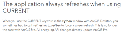

Unfortunately they took away the refreshActiveView option in pro.  If possible use CURRENT for the map.
https://pro.arcgis.com/en/pro-app/latest/arcpy/mapping/migratingfrom10xarcpymapping.htm
The application always refreshes when using CURRENT
When you use the CURRENT keyword in the Python window with ArcGIS Desktop, you sometimes had to call refreshActiveView to force a screen refresh. This is no longer the case with ArcGIS Pro. All arcpy.mp API changes directly update ArcGIS Pro."

That is completely correct and actually I remember reading this link in the past. SetLayers is used to turn layers on/off before running a procedure to create images. As a test I ran it how it currently works (using a passed in path to a project), I set it to create 4 images but killed the script after 12 minutes and having created 2 of the images.
I then changed my code to use 'CURRENT', reran the test and it created all 4 images in 35 seconds!
Thanks for the reminder. 🙂
