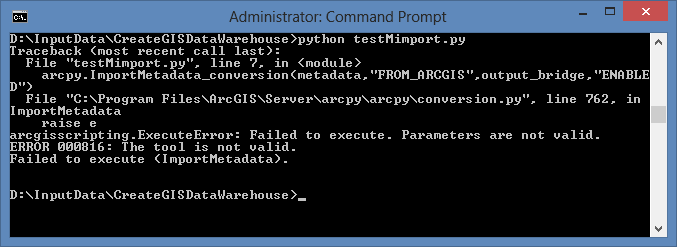

Are you getting any errors?
MichaelMiller2
Errors when run on server

Both ImportMetadata_conversion and MetadataImporter_conversion work when invoked in a test script on the desktop, but neither work when invoked by the same test script on ArcGIS server.
