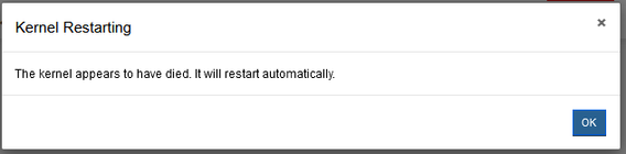

Running in an AGOL Notebook (AGOL for Organizations), however, just doing the import for this crashes the kernel. I get an error pop-up titled "Kernel Restarting" with the message "The kernel appears to have died. It will restart automatically." The browser window never restarts the kernel and it just sits there with a "Dead kernel" message and an icon with a spy-vs-spy bomb with a lit fuse.

When it runs the import (line 2), I get this pop-up:
Despite what the error message says, I have never seen it restart itself in my browser tab, which just sits there with these ominous looking icons:
