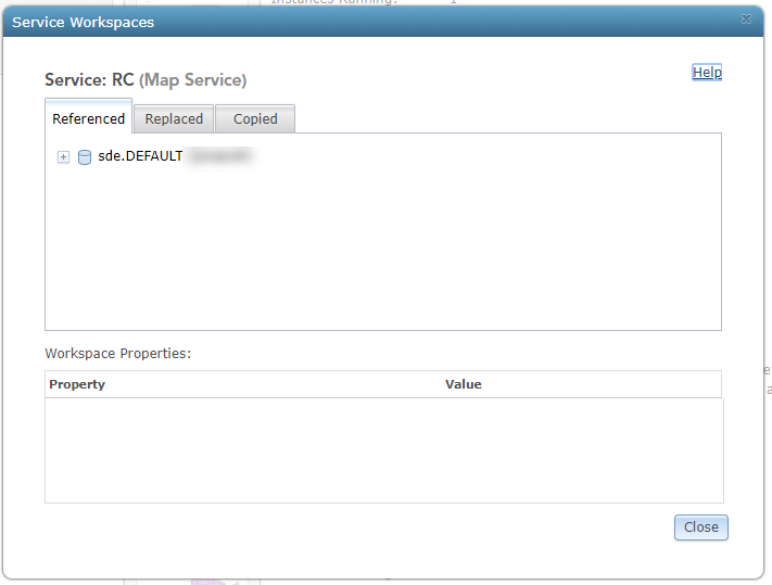

If you have referenced data in a service, then I assume you have ArcGIS Server so if you were to open Manager, all SOC based services have a Service Workspaces button:
From here, you can see the referenced, replaced, and copied data sets:
