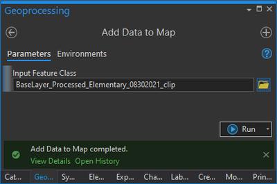

Tool interface:

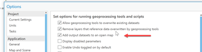

DanPatterson
MVP Esteemed Contributor
this is checked on as well?
... sort of retired...
JaredPilbeam2
MVP Alum
Dan,
Didn't realize that was there. It's checked on, anyway.

JaredPilbeam2
MVP Alum
That works. It makes sense that the script tool didn't know the map. Thanks for pointing that out. Nowhere did I come across .activeMap in the help pages.
