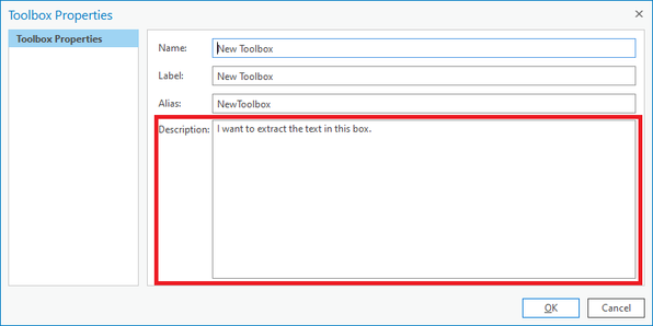

Is it possible to grab a toolbox description via arcpy? Or maybe by using another library?

Just about everything but
import arcpy
pth = r"C:\arcpro_npg\npg_tools.tbx"
t0 = arcpy.ImportToolbox(t)
arcpy.Usage(t0)
tools = arcpy.ListTools(t0)
for tool in tools:
    print(arcpy.Usage(tool))
AttributeSort_npg({Tool}, Input_features, Sort_fields;Sort_fields..., {Output_field})
... snip ...
Triangulate_npg(Tool, Input_Features, Output_Features, {Polygon | Polyline}, {True | False})
t1 = tools[0]
help(arcpy.AttributeSort_npg)
Help on function AttributeSort:
AttributeSort(Tool=None, Input_features=None, Sort_fields=None, Output_field=None)
       Sort by attributes.
    INPUTS:
     Tool {String}:
         Tool being used. Informational only.
     Input_features (Table View):
         The feature attributes to sort. Select a layer if prior selections
         are to be honored.
     Sort_fields (Field):
         Fields to sort on, in order of importance.
     Output_field {String}:
         The field to create to contain the sort results.
... sort of retired...

GB_MattPanunto_GISS
arcpy.Usage() works great after importing the toolbox, thanks!
