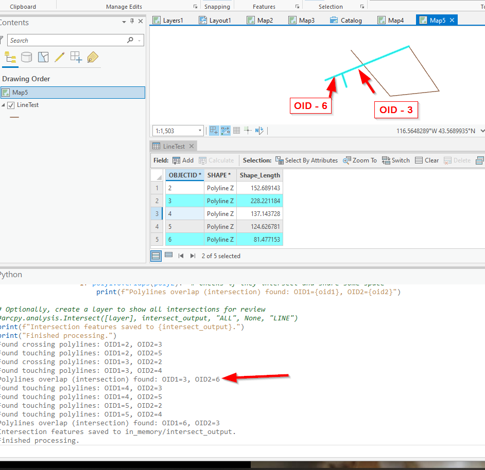

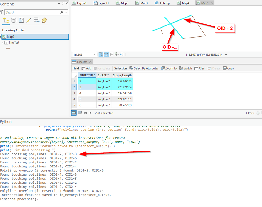

I did some testing on some code and here are my results, hopefully it helps.
Found crossing polylines: OID1=2, OID2=3
Found touching polylines: OID1=2, OID2=5
Found crossing polylines: OID1=3, OID2=2
Found touching polylines: OID1=3, OID2=4
Polylines overlap (intersection) found: OID1=3, OID2=6
Found touching polylines: OID1=4, OID2=3
Found touching polylines: OID1=4, OID2=5
Found touching polylines: OID1=5, OID2=2
Found touching polylines: OID1=5, OID2=4
Polylines overlap (intersection) found: OID1=6, OID2=3
Intersection features saved to in_memory/intersect_output.
Finished processing.
EugeneSosnin_GSI
@TonyAlmeida , I am sorry, but it does not help.
Frankly, I even don't understand which polyline is which on your plot. Seems like instead of having one polyline, you created three: 6,3,2. Other polylines seems to be similar. It's completely irrelevant to my case. I showed you a simple example of two polyline, that touch and cross each other simultaneously. And they will never return touches==True, unless crossing is False. Simple.
