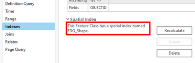

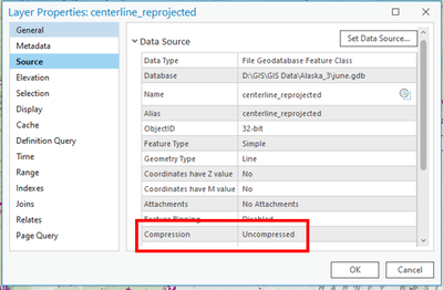

So here is a screen shot of the properties of a dataset note it is UNCOMPRESSED and has a SPATIAL INDEX
When I run the following code in the Python console in ArcPro 3.0 I get the expected results
desc = arcpy.Describe('centerline_reprojected')
desc.hasSpatialIndex
True
Now... I run the compress file geodatabase tool to compress the dataset, and to prove I did this here are the properties
Now if I run the same bit of code I get False
False
Finally if I un-compressed the data it clearly states in the properties that the spatial index exists.
