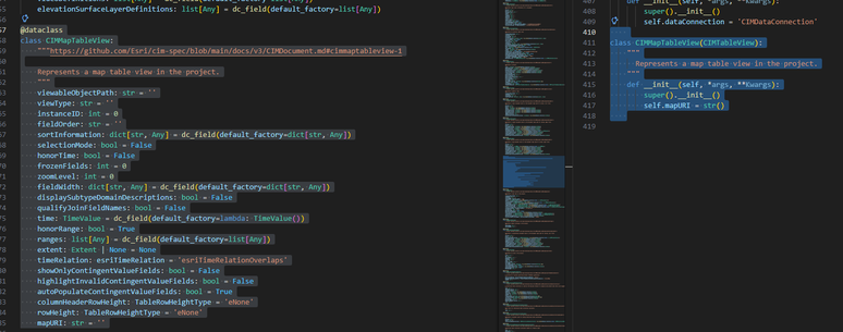

Original CIM with inheritance on right, flat cimple.cim on left

Since most of the time when you're type narrowing CIM, you're really just looking for a specific set of keys, I think this is the most sensible solution. It will likely diverge from the base CIM inheritance model though since simple classes that have only simple attributes like 'name' and 'type' will now be considered to be related.
Alternatively, I could re-write the script to honor the inheritance hierarchy, with the drawback that inheritance may cause some weird issues with circular imports (the reason the cim module uses strings is to defer this to runtime). Since right now no classes inherit from any other cim class, it is safe to defer the typing and defaults to runtime where all classes are loaded in and can be initialized.
