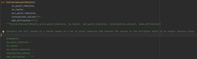

For example, the ExtractValuesToPoints signature and docstring show me:
def ExtractValuesToPoints(
        in_point_features,
        in_raster,
        out_point_features,
        interpolate_values="#",
        add_attributes="#"):
    """ExtractValuesToPoints_sa(in_point_features, in_raster, out_point_features, {interpolate_values}, {add_attributes})
    Extracts the cell values of a raster based on a set of point features and records the values in the attribute table of an output feature class.
    Arguments:
    in_point_features -- The input point features defining the locations from which you want to extract the raster cell values.
    in_raster -- The raster dataset whose values will be extracted.
    out_point_features -- The output point feature dataset containing the extracted raster values.
    interpolate_values -- Specifies whether interpolation will be used.
    add_attributes -- Determines if the raster attributes are written to the output point feature dataset."""
The add_attributes argument doesn't tell me what values I can use.

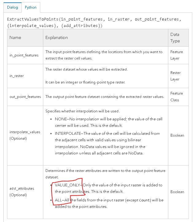

For that I have to go to the web documentation:
add_attributes
(Optional)
VALUE_ONLY—Only the value of the input raster is added to the point attributes. This is the default.
ALL—All the fields from the input raster (except Count) will be added to the point attributes.
Boolean
This adds multiple extra steps every time you look up a signature. It'd be nice if they were aligned so I don't have to constantly leave my IDE.

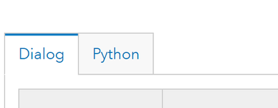

I can't remember from the last beta, but does the locally installed version have this tab
if memory serves there may not be both for reasons I can't remember
by Anonymous User
@DanPatterson When I click on the help button from the GUI toolbox, it just sends me to the website. I'm not sure where to find these tabs locally.

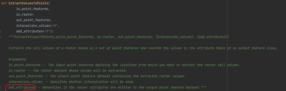

Here's a screen grab showing the difference between arcpy docstrings and the web docs. From within arcpy, I cannot see the add_attributes values "VALUE_ONLY" and "ALL".

In ArcGIS 3.0, this documentation has actually gotten worse. Here's a screenshot of the same function from 3.0. Now there is even less information than before.
The module header docstring states that the module is autogenerated... maybe this is just an oversight?
