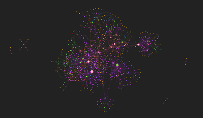

Here's an Index.json that I visualized with vizjs, it's incredibly complex:
A minimal APRX is just a DocumentInfo.xml, GISProject.json, and Index.json file in a zipped directory (using defalte compression) with the suffix .aprx so Windows knows to use Pro to open it. You can also just right click the zip and open in Pro and it'll work too.
