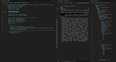

It's read as a readonly memoryview. You can lop off the first 8 and last 11 bytes to get a serializable bytestring, then load that in (I had to roll my own Decoder using some of the functions in .cimloader.jsontocim), but the final output is something like the far right of that image. You can then write the data back to the field using an update cursor, but you need to write the raw bytes, because a memoryview will be referencing garbage collected data after it leaves scope.
It does seem to update something, but whatever those leading and trailing bytes are seem to be important and even adding them back to the bytearray after updating the CIM object just destroys the Annotation. It successfully updates the field, but the annotations vanish from the map and can only be deleted by removing them from the table directly.
There is also a Point object stored in the leader point field of the Annotaiton CIM that could theoretically be moved too, but as far as I can tell, there's no way to apply the updates to an existing Annotation. You could still use this to run some validations using the expanded information in the CIM, but that's much less useful than being able to directly update the CIM in place.
