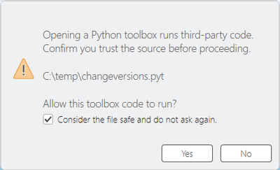

DrewFlater
Status changed to: In Product Plan
The warning dialog box that appears when you open a custom Python toolbox has a new checkbox to Consider the file safe and do not ask again in the ArcGIS Pro 3.8 early adopter snapshot builds.
AlfredBaldenweck
Great! Will that be saved per-project or via something like Favorites or the user.config file to be trusted across all projects?
DrewFlater
@AlfredBaldenweck the choices you make in the warning dialog are stored in a dedicated file in the user profile (not the user.config) and applies across all projects.
