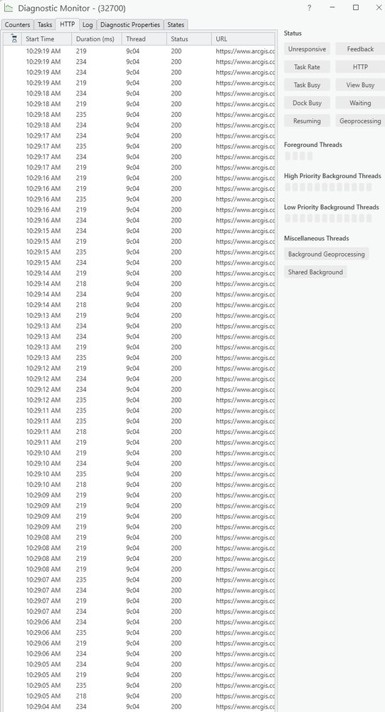

Pro 3.3.2 seems to do a LOT of license checking.
When you open the Diagnostic Monitor you will see that for almost everything you do, Pro will do multiple successive license checks.
Paste a value into an attribute table of a locally saved FC in a local FGDB: 4 checks
Rename a map: 76 checks
The log will be filled with:
<HTTPRequest start="5/11/2024 10:20:05 AM" duration="235" thread="39940" status ="200" url="https://www.arcgis.com/sharing/rest/portals/MYAGOLACC/subscriptionInfo?token=THETOKEN&f=json"</HTTPRequest>
I understand the need to monetise and audit users but how about doing this during an idle moment/startup and reporting a timestamp so you do it once a day?
Rename a map:
+ (had to scroll to copy them all)
That is 19 seconds of unresponsive UI.

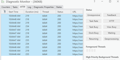

Change the transparency of a fill colour - 12 checks. (right click a fill colour in ToC, set transparency, close dialog)

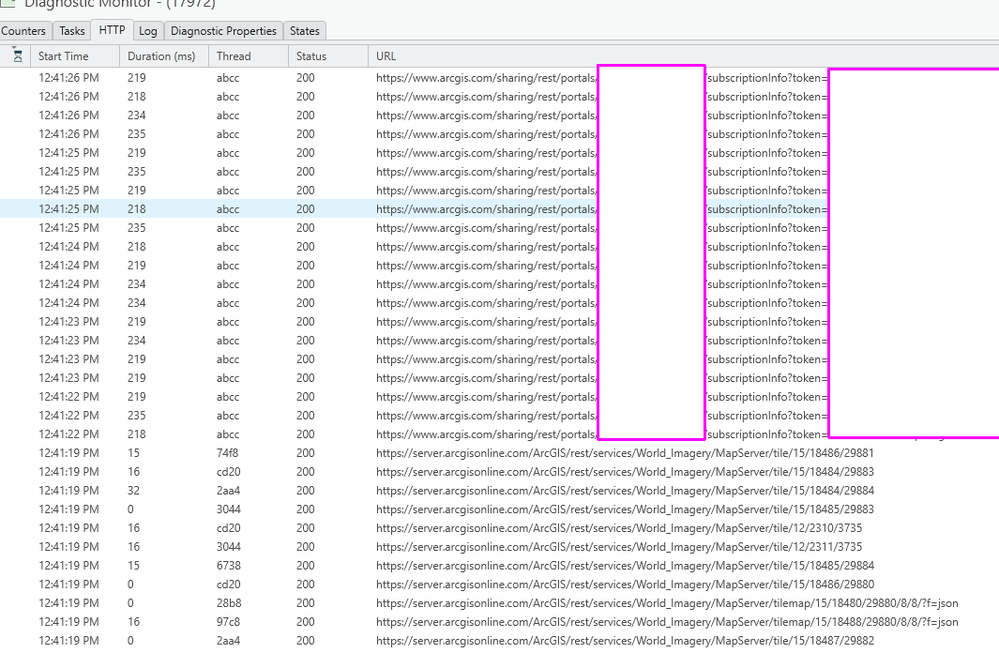

@RTPL_AU  If possible could you expand your screenshot of Diagnostic monitor. I would love to see the https license call url more in 3.3.2? And do you have any layers from an AGOL in your maps?   Thank you for any information.
I apologize you put the URL in your comments.  thank you.  I am interested if you do have any AGOL  layers in your maps.
RTPL_AU
@Stacey_Crowe  it varies.
Maps may have an AGOL basemap.
Map service calls are not mixed with license calls - which is what I would expect to see if it was checking if you are allowed to access a resource.
You will see something like below if there are webservices loaded - It will do a map load/refresh/load tiles, and then go off testing the license 20 times for 4 seconds while the UI is unresponsive.
