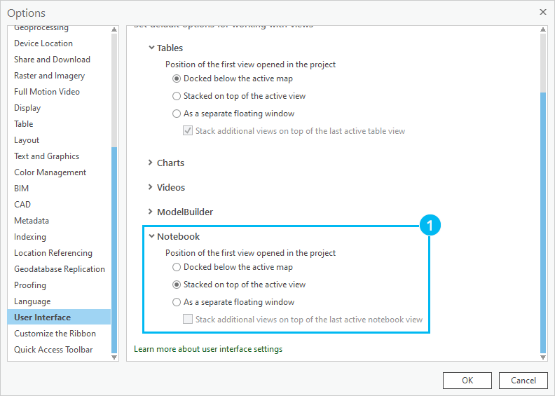

In the realm of notebooks in Pro, you can now choose the position of your notebooks when first opened in a Project. You can find this option in the Project Settings >> Option dialog under the User Interface tab. At the bottom, expand the Notebook section and choose from 1) stacking the map on top of the active map (default), docking the view below the active map, or opening the view in a separate window.
