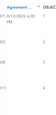

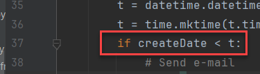

@James_Shreeve I only see one date in the feature service, and it's a few weeks in the future:
So you will need to change the below line from > to <, and it will generate an e-mail:
