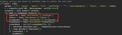

Monika Samorajska‌ are you looking to include additional fields other than the OBJECTID in the e-mail?
MonikaSamorajska1
Hi  Jake Skinner
Ideally I woul like to have more information, like two more fields, but I think this script is looking for the "OBJECTID" field and the information about "OBJECTID" is enough for me, as this is probably the only uniqeid which I have in the service. Are you able to help me with the code to achive that?

JakeSkinner
Esri Esteemed Contributor
Monika Samorajska‌ can you share the service to an ArcGIS Online group and invite my user account (jskinner_CountySandbox)?  Can you also let me know what information you want included in the notification?
MonikaSamorajska1
Jake Skinner‌ I have invited you yo the group. So the Feature Service contain one feature class with the equipment location and thwo related tables. One table is related to the Feature Class and the other table is related the the first  The feature service is editable of-course. In the e-mail I would like to have the information depending on what has been changed, when the new feature was added to the feature class I would like to receive an e-mail which says that the "oOBJECTID" number 1 (for example) has been added, when the information in related table has been changed I would like to have the information that "objectid" nr 1 in related table has added.
Please let me know if you understand my request.

JakeSkinner
@MonikaSamorajskatake a look at the below code:
import requests, json, datetime, time, smtplib, math
from datetime import timedelta
from email.mime.text import MIMEText
# Disable warnings
requests.packages.urllib3.disable_warnings()
# Variables
username = 'jskinner_CountySandbox'                                                                                   # AGOL Username
password = '*******'                                                                                                  # AGOL Password
URL = 'https://services.arcgis.com/dlFJXQQtlWFB4qUk/ArcGIS/rest/services/CitizenProblems/FeatureServer/0/query'       # Feature Service URL
dateField = 'CreationDate'                                                                                            # Date field to query
hoursValue = 1                                                                                                        # Number of hours to check when a feature was added
fromEmail = '[email protected]'                                                                                       # Email sender
toEmail = ['[email protected]']                                                                                       # Email receiver(s)
smtpServer = 'smtp.esri.com'                                                                                          # SMTP Server Name
portNumber = 25    # SMTP Server port
# Function to send email
def sendEmail():
    SUBJECT = 'Problem Reported'
    TEXT = "{0} was created with status {1} and has been assigned to {2}".format(typeProb, status, assignedto)
    smtpObj = smtplib.SMTP(host=smtpServer, port=portNumber)
    msg = MIMEText(TEXT)
    msg['Subject'] = SUBJECT
    msg['From'] = fromEmail
    msg['To'] = ", ".join(toEmail)
    smtpObj.sendmail(fromEmail, toEmail, msg.as_string())
    print("Successfully sent email")
    smtpObj.quit()
# Generate AGOL token
try:
        print('Generating Token')
        tokenURL = 'https://www.arcgis.com/sharing/rest/generateToken'
        params = {'f': 'pjson', 'username': username, 'password': password, 'referer': 'http://www.arcgis.com'}
        r = requests.post(tokenURL, data=params, verify=False)
        response = json.loads(r.content)
        token = response['token']
except:
        token = ''
# Return largest ObjectID
whereClause = '1=1'
params = {'where': whereClause, 'returnIdsOnly': 'true', 'token': token, 'f': 'json'}
r = requests.post(URL, data = params, verify = False)
try:
    response['objectIds'].sort()
except Exception as e:
    print("Error: {0}".format(e))
count = len(response['objectIds'])
# Query service and check if editDate time is within the last hour
if count < 1000:
    params = {'f': 'pjson', 'where': "1=1", 'outFields' : '*', 'returnGeometry' : 'false', 'token' : token}
    r = requests.post(URL, data=params, verify=False)
    for feat in response['features']:
        typeProb = feat['attributes']['probtype']
        status = feat['attributes']['status']
        assignedto = feat['attributes']['assignedto']
        createDate = feat['attributes'][dateField]
        createDate = int(str(createDate)[0:-3])
        t = datetime.datetime.now() - timedelta(hours=hoursValue)
        t = time.mktime(t.timetuple())
        if createDate > t:
           sendEmail()
Where I'm creating choosing which fields to include in the e-mail is the below section:
I'm selecting fields probtype, status, and assignedto.  The e-mail is sent through a function where these new field variables are included in the message:
