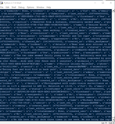

 Here is some of the output. Is there a way to remove the []
'Was animal Aggressive?: ['No']'
What was the animal Reaction?: ['Didnt see me']'
'More Details about the sighting: ['Mama and two cubs filmed by the motion-detecting doorbell camera as they passed across the yard']'

@RickeyFight
For your e-mail text, try cleaning up the extra apostrophes.  For example, you have:
ReportedReaction = "'\nWhat was the animal Reaction?: " + str(reaction)
Try this instead:
ReportedReaction = "\nWhat was the animal Reaction?: " + str(reaction)
You won't need any quotes around \n, as long as it's enclosed by quotes, python will read it is a new line.
To remove the [] around the answers, you have two options:
1.  Since you are appending to a list, you can specify the first value of the list using a [0].  Ex:
Sighted = "\nAnimal Sighted : " + str(probtype)[0]
2.  Instead of creating a list (i.e. probtype = []), you can remove this and set the probtype as a variable:
probtype = (str(feat['attributes']['probtype']))
I would recommend the second option.  In doing so, you should move everything within the for loop.  This will allow separate e-mails to be sent in the event there is more than 1 feature added within the allotted time the script executes:

MVP Alum
@JakeSkinnerThe token printed!
after the token I got this error:
{'returnGeometry': 'false', 'outFields': '*', 'statisticType': 'count', 'where': '1=1', 'f': 'pjson'}
{u'error': {u'message': u'Token Required', u'code': 499, u'details': []}}
File "C:\Users\user\Desktop\TestEmailSend.py", line 69, in <module>
for feat in response['features']:
KeyError: 'features'
JakeSkinner
Esri Esteemed Contributor
@RickeyFight ,
You will need to apply the token to your params when querying the service:
params = {'f': 'pjson', 'where': "1=1", 'outFields' : '*', 'statisticType' : 'count', 'returnGeometry' : 'false', 'token' : token}
RickeyFight
MVP Alum
@JakeSkinner
That got it to run! Thank you!
Took way longer then expected and loaded a bunch of data then froze a few times. I am not sure why it keeps freezing. I tired running at a shorter interval (5min) and it still hangs up. I am afraid that if I run this on task scheduler that it will break my server. Any ideas?
I think it might be loading all features and there are over 1000
Edit: Before I edited the code it would just load the features that were created last and send an email. I am not sure what has changed besides logging in.
EDIT EDIT: I took out the print(response) and it fixed the issue.
