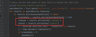

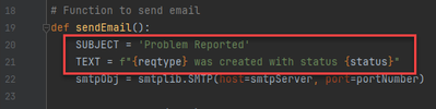

The below example is written for the Citizen Problem Report application.  It utilizes 2 fields (reqtype & status) when querying the service.  These variables can be commented out, or updated to reference different fields, if working with a different service:
The SUBJECT and TEXT variables in the sendEmail function can be updated to whatever you would like to include in the e-mail:

def sendEmail():
    SUBJECT = 'Problem Reported'
    TEXT = f"{reqtype} was created with status {status}"
    smtpObj = smtplib.SMTP(host=smtpServer, port=portNumber)
    msg = MIMEText(TEXT)
    msg['Subject'] = SUBJECT
    msg['From'] = fromEmail
    msg['To'] = ", ".join(toEmail)
    smtpObj.sendmail(fromEmail, toEmail, msg.as_string())
    print("Successfully sent email")
    smtpObj.quit()

print("Querying feature service")
queryResults = fLyr.query(where='1=1', out_fields="*", return_geometry=False)
for results in queryResults.features:
    if results.attributes[dateField] != None:
        createDate = results.attributes[dateField] / 1000
        reqtype = results.attributes['reqtype']
        status = results.attributes['status']
        t = datetime.datetime.now() - timedelta(hours=hours)
        t = time.mktime(t.timetuple())
        if createDate > t:
           sendEmail()
