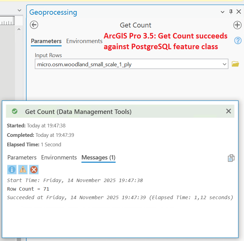

I unfortunately have identified two other issues in Pro 3.6:
1) - The Get Count  geoprocessing tool now fails with a non(!) enterprise geodatabase enabled ordinary PostgreSQL enterprise database feature class. This used to work in Pro 3.5 and below. According to the "What's new in Pro 3.6", the Get Count tool had changes applied for Pro 3.6, that seems to break this option. See the images entirely below.
2) - Using a Python "concurrent.futures.ThreadPoolExecutor" seems to make the geoprocessing in Pro 3.6 hang at the end of the thread pool processing if the processing is run in the Pro Foreground Thread. I do not see these hangs if Pro 3.6 is set to run in the background Geoprocessing Thread, which is the default.
Issue_ArcGIS_Pro_3_6_Get_Count_fails_Pro_3_5_result.pngIssue_ArcGIS_Pro_3_6_Get_Count_fails_Pro_3_6_result.png

I need to do more testing to see if can pinpoint a culprit in my coding that might point to a Pro issue (or just some weird Python related thing, or the way my Python code in these particular modules involved is setup that causes the issue).
MarcoBoeringa
MVP Alum
@JeffBarrette and @HannesZiegler ,
More important observations, see screenshots including debugger:
MarcoBoeringa
MVP Alum
@JeffBarrette
This is the full code of the 'updateSymbology' function. Note that I call it with 'aprxMap=None', see in the debugger.
Also note that in the particular example shown in the screenshots above, the 'len(inputSymbologyFields)=0' because it is a single symbol legend type.
Lastly, note that it is actually a string file path to the layer file stored on disk that is input to the actual call to the "Apply Symbology From Layer" tool, NOT the 'symbologyLayer' (which is however based on it, and was added to the TOC for technical reasons), which is in this function just used to check for symbology fields.
