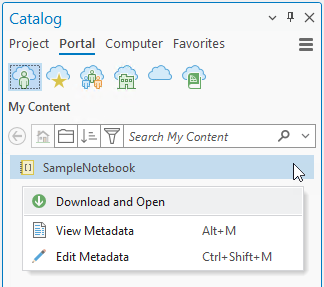

  • Using Notebooks hosted on Enterprise Portal in ArcGIS Pro: There are several options for moving a hosted notebook to your local machine.
    • igned into a portal within ArcGIS Pro. From the Catalog pane in ArcGIS Pro, go to Portal > My Content, right-click a notebook item, and select Download and Open.
    • Signed into Portal on the web browser. From the Notebook Editor in Portal, on notebook menu ribbon, click File> Download as > notebook (.ipynb).
    • Signed into Portal on the web browser. From the notebook's Item Details page (accessible from the Content tab by clicking on a notebook item), click Download to download the notebook in .ipynb format.
