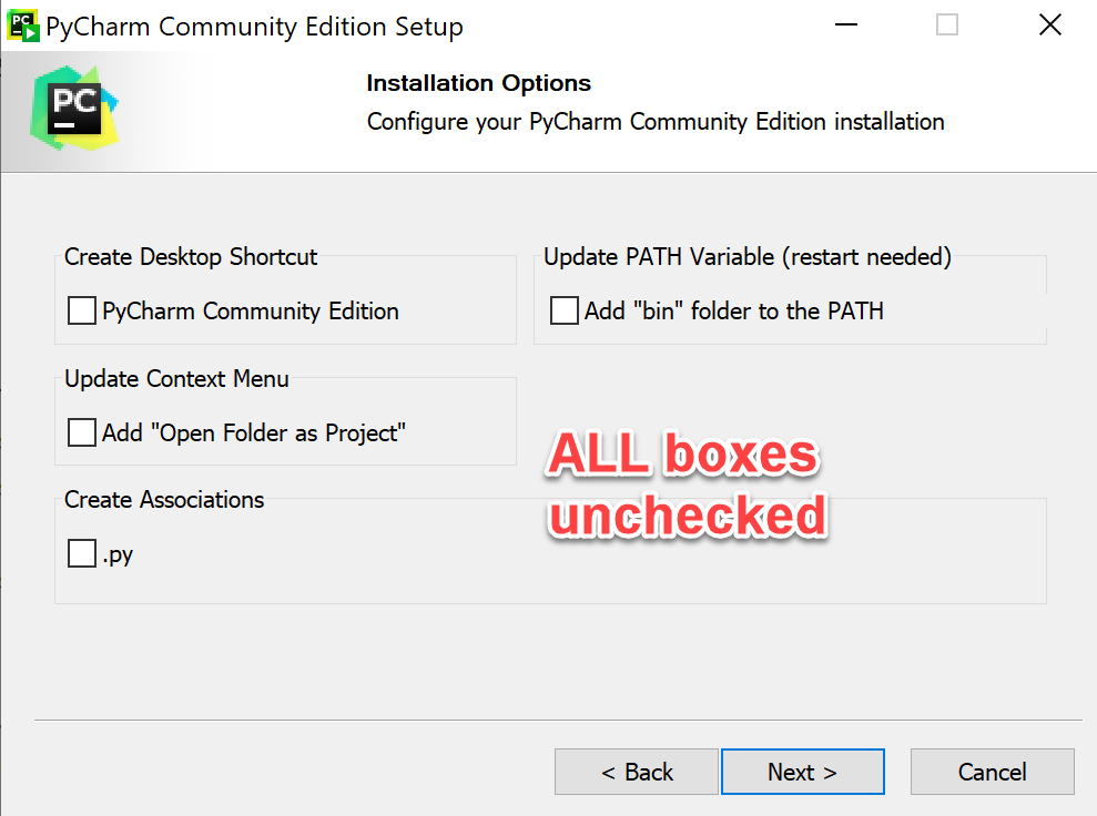

PyCharm download and install
PyCharm Community Edition is free to download from www.jetbrains.com. The Community Edition has pretty much all you will need, the professional ($) edition is worth looking into if you need to code in JavaScript or SQL, it has many useful features for that kind of development. But for coding Python scripts, the free community edition is fine.
When you run the installer be sure not to click any of the boxes on the setup dialog, it's best to keep your Windows paths and settings "clean", to avoid messing with Windows settings on which other applications may be dependent.  We will be setting preferences within PyCharm to make it play well with ArcGIS.

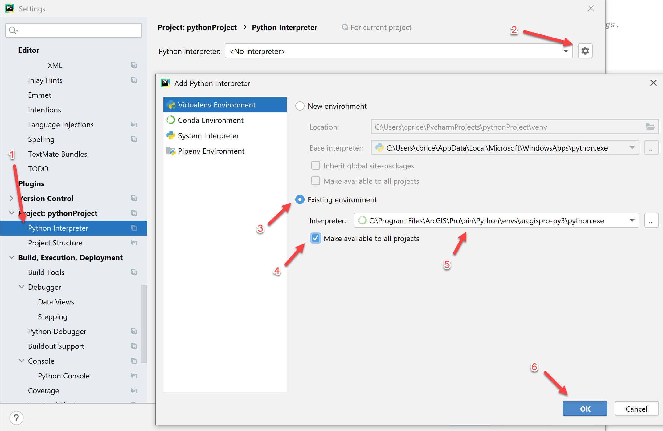

Configure Python interpreter for ArcGIS Pro
After PyCharm launches, click the gear at the upper right corner of the screen (or press Ctrl-Alt-S) to open the settings dialog. You can set up PyCharm with multiple Python interpreters, and we want to make the default setup for ArcGIS Pro (you can choose others though, which is handy!)
  1. Select Python Interpreter at left
  2. Click the gear icon at upper right and select Add
  3. Select the Existing environment radio button
  4. Click (set) Make available to all projects
  5. For Interpreter:  click the ... icon at right and navigate to and select the python.exe for Pro:
    C:\Program Files\ArcGIS\Pro\bin\Python\envs\argispro-py3\python.exe
  6. Click OK.
