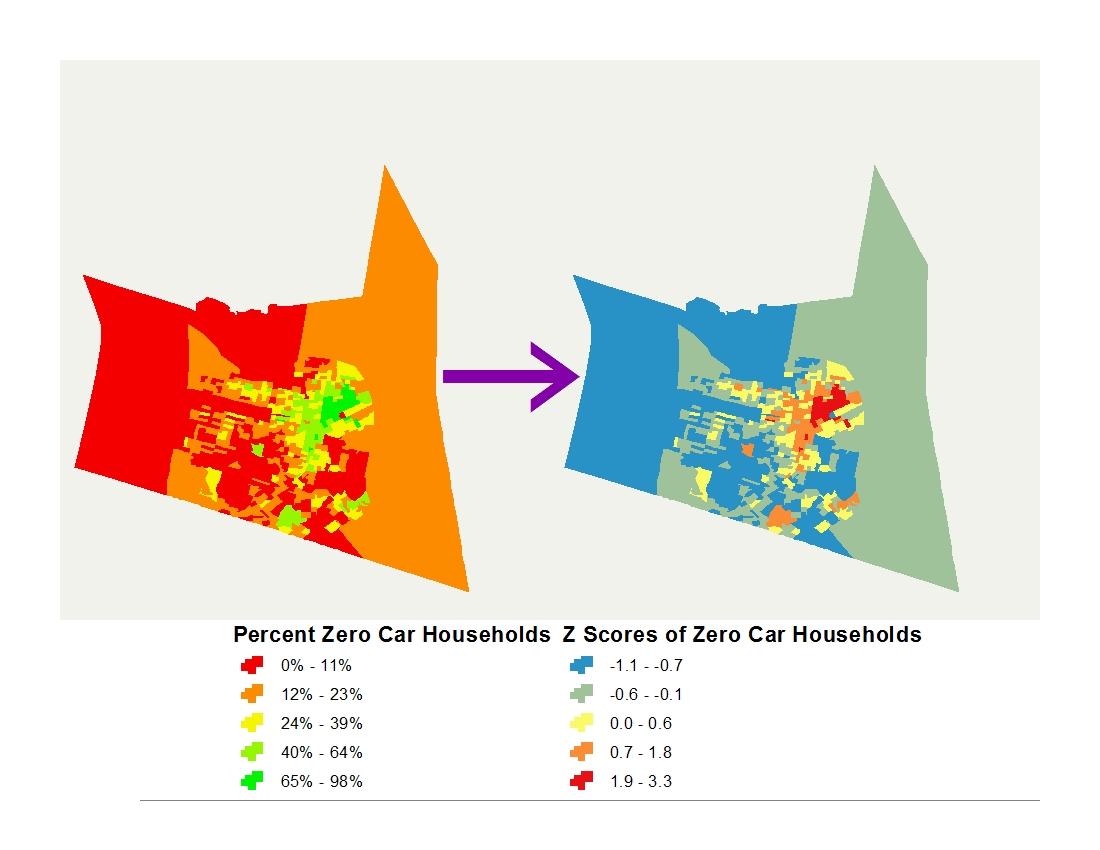

Add Z Scores Tool: This 10.4 ArcGIS scripting tool is designed to take selected fields and create an added field with a Z score for each one of the selected fields. The script essential exports a table to a numpy array, then to a dataframe, and then uses pandas to calculate new columns with corresponding Z Scores for the fields selected.
