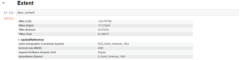

With ArcGIS Pro 2.9, there are several updates that improve your experience, including the following:

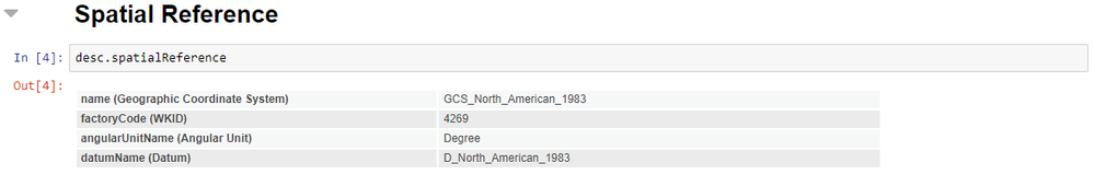

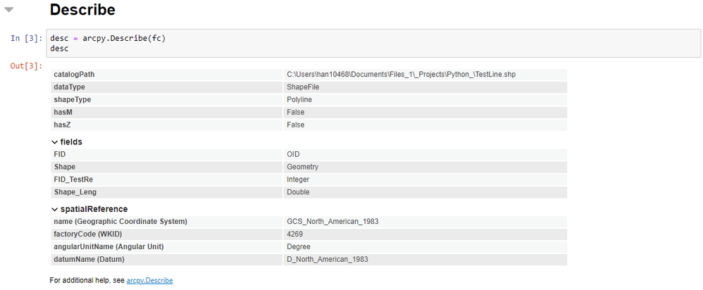

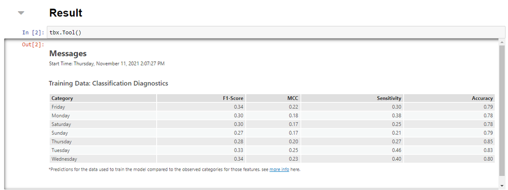

  • Added rich representations to the ArcPy SpatialReference, Extent, Describe, and Result objects.
    • SpatialReference
    • Extent
    • Describe
    • Result

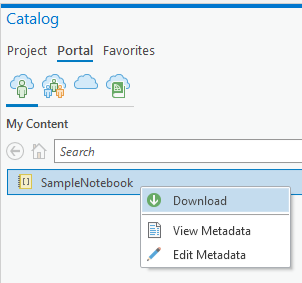

    • Make sure you are signed into a portal. From the Catalog pane in ArcGIS Pro, go to Portal > My Content, right-click a notebook item, and select Download.

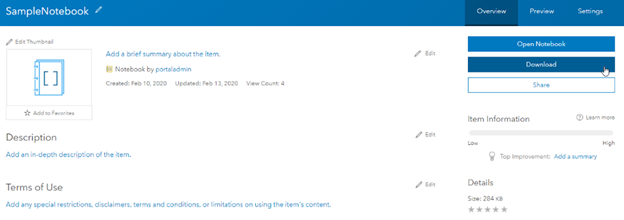

    • Signed into Portal on the web browser. From the notebook's Item Details page (accessible from the Content tab by clicking on a notebook item), click Download to download the notebook in .ipynb format.

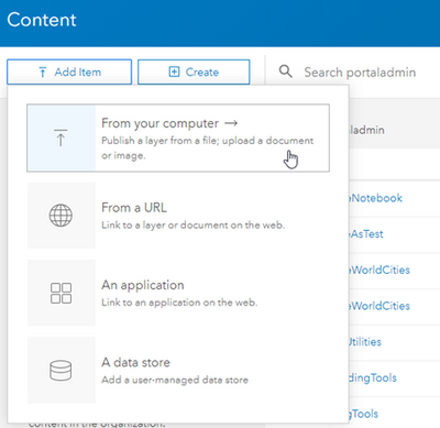

    • You can upload any notebook file (.ipynb) to your portal. Sign into your organization's Portal from the browser, go to the Content tab of the contents page, click Add Item > From your computer and choose From my computer. From the Add an item from my computer dialog, click Choose File and browse to a notebook file on your computer, provide a title and tags, and then click Add Item.
