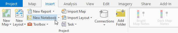

To get started with notebooks in Pro, open a new project and from the Insert ribbon click New Notebook. Creating a new notebook will immediately open it, allowing you to jump right into entering code
Note: You can arrange the notebook view so that you can see your map and notebook side-by-side.

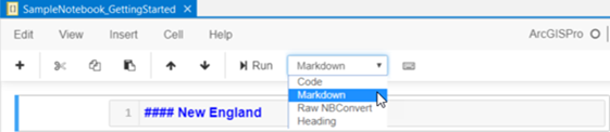

3. Select Markdown from the drop-down list above the cell, and from the Cell menu of the notebook view select Run Cells And Select Below. This runs the cell and simultaneously creates a new cell below (or selects it if a cell already exists below the cell being executed).
The text becomes a header and description for your notebook. Markdown allows you to narrate a notebook and break it into sections.

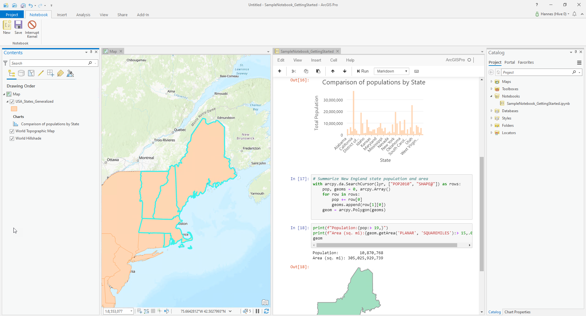

As of ArcGIS Pro 2.6, charts can be displayed in notebooks. To add a chart to a layer or notebook, first create a Chart object, then configure its properties, and finally associate the Chart with an arcpy.mp.Layer from an arcpy.mp.ArcGISProject. The above code adds a chart to the map layer and prints the result in the notebook cell output area.
6. Arrange the map and notebook views so they are both visible side-by-side.
7. Geoprocessing operations performed in the notebook will honor selections made in Pro. Complete steps 8-9 with the five states (Maine, Massachusetts, New Hampshire, Rhode Island, and Vermont) selected.
From the Map ribbon click the Select button and select the states Maine, Massachusetts, New Hampshire, Rhode Island, and Vermont.
We can see the relative size of the populations of these individual states compared to other states. We would like to report the total population and area of these five states. To do that, we will use the notebook.
8. In the next cell, enter the following code and press Shift+Enter:
# Summarize New England state population and area
with arcpy.da.SearchCursor(lyr, ["POP2010", "SHAPE@"]) as rows:
    pop, geoms = 0, arcpy.Array()
    for row in rows:
        pop += row[0]
        geoms.append(row[1][0])
    geom = arcpy.Polygon(geoms)
The code iterates through the selected population and geometry records of the USA_States_Generalized dataset. It totals the population and stores the result in the pop variable. While iterating, it also combines the geometries of the individual states into a single arcpy.Polygon object stored in the geom variable.
9. In the next cell, enter the following code and press Control+Enter, this will run the cell without creating a new cell below.
print(f"Population:{pop:> 19,}")
print(f"Area (sq. mi):{geom.getArea('PLANAR', 'SQUAREMILES'):> 15,.0f}")
geom​
The code prints out the population and area of the five selected states. Thanks to rich representations in notebooks, the geometry of the five states is also displayed directly in the notebook. The result is a document that reports the population and area of New England states, and shows a visual representation of the five state's combined shape.

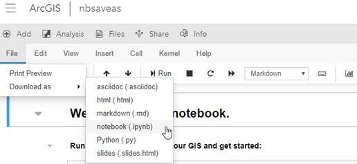

    • Signed into Portal on the web browser. From the Notebook Editor in Portal, on notebook menu ribbon, click File> Download as > notebook (.ipynb).ArcGISOnlineDownloadNotebook.pngArcGISOnlineDownloadNotebook.png

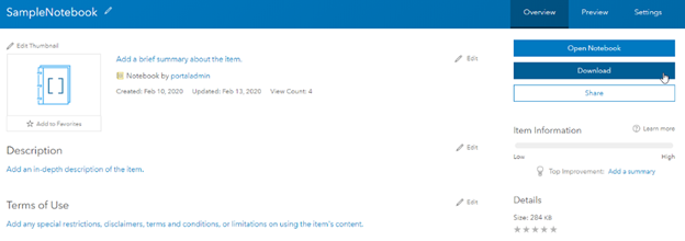

    • Signed into Portal on the web browser. From the notebook's Item Details page (accessible from the Content tab by clicking on a notebook item), click Download to download the notebook in .ipynb format.WebPortalDownloadNotebook.pngWebPortalDownloadNotebook.png

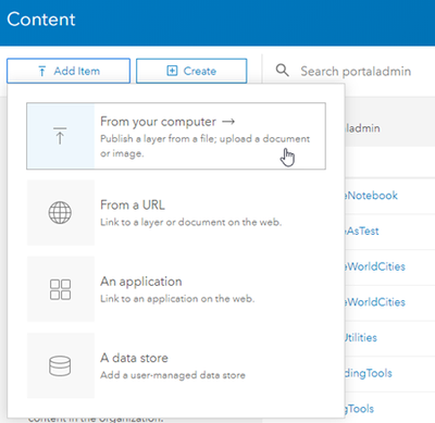

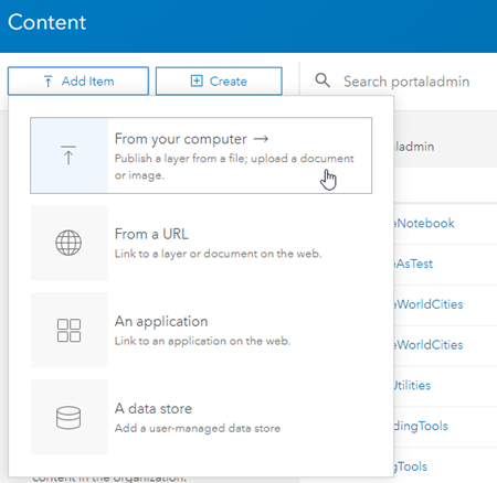

    • You can upload any notebook file (.ipynb) to your portal. Sign into your organization's Portal from the browser, go to the Content tab of the contents page, click Add Item > From your computer and choose From my computer. From the Add an item from my computer dialog, click Choose File and browse to a notebook file on your computer, provide a title and tags, and then click Add Item.
