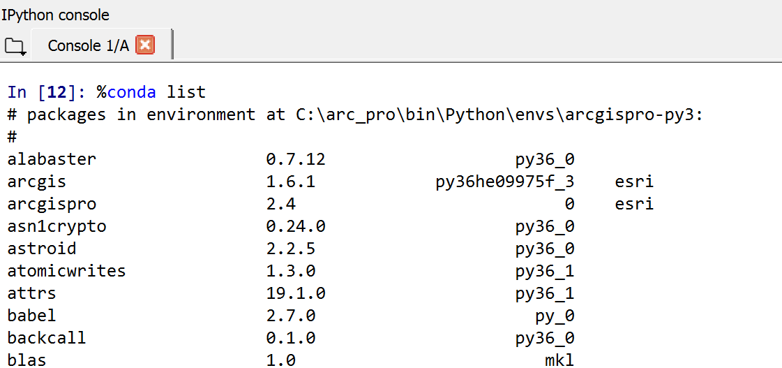

Recently stumbled upon…          Using conda in spyder
I will just leave this as a thought.  It is one of those IPython %magic things

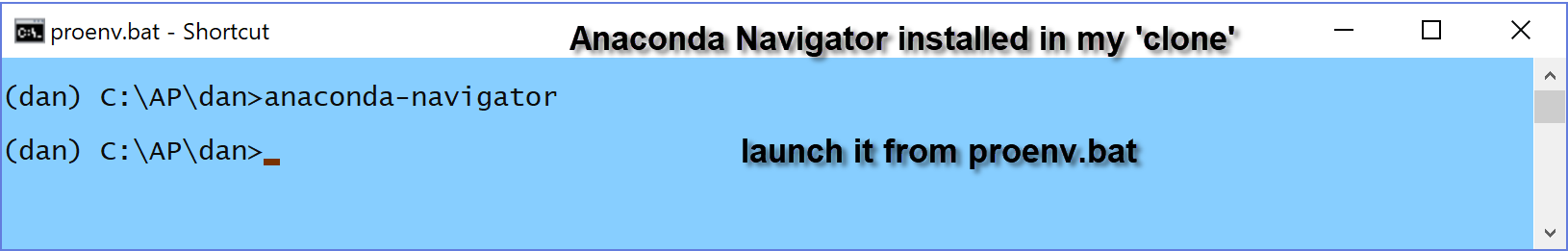

 Spyder... install once, use in multiple environments New... 2018-08-30

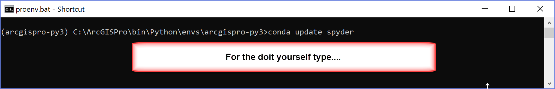

    Version 3.3.6: installed 2019-07-16
    Use proenv.bat and just ran..... conda update spyder

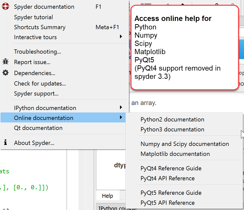

Script documenting ... It is all in the docs - links to spyder help pane for user-created help.
Spyder on GitHub ... If you want to keep abreast of issues and/or enhancement requests
Spyder Documentation …. On GitHub or Spyder Documentation

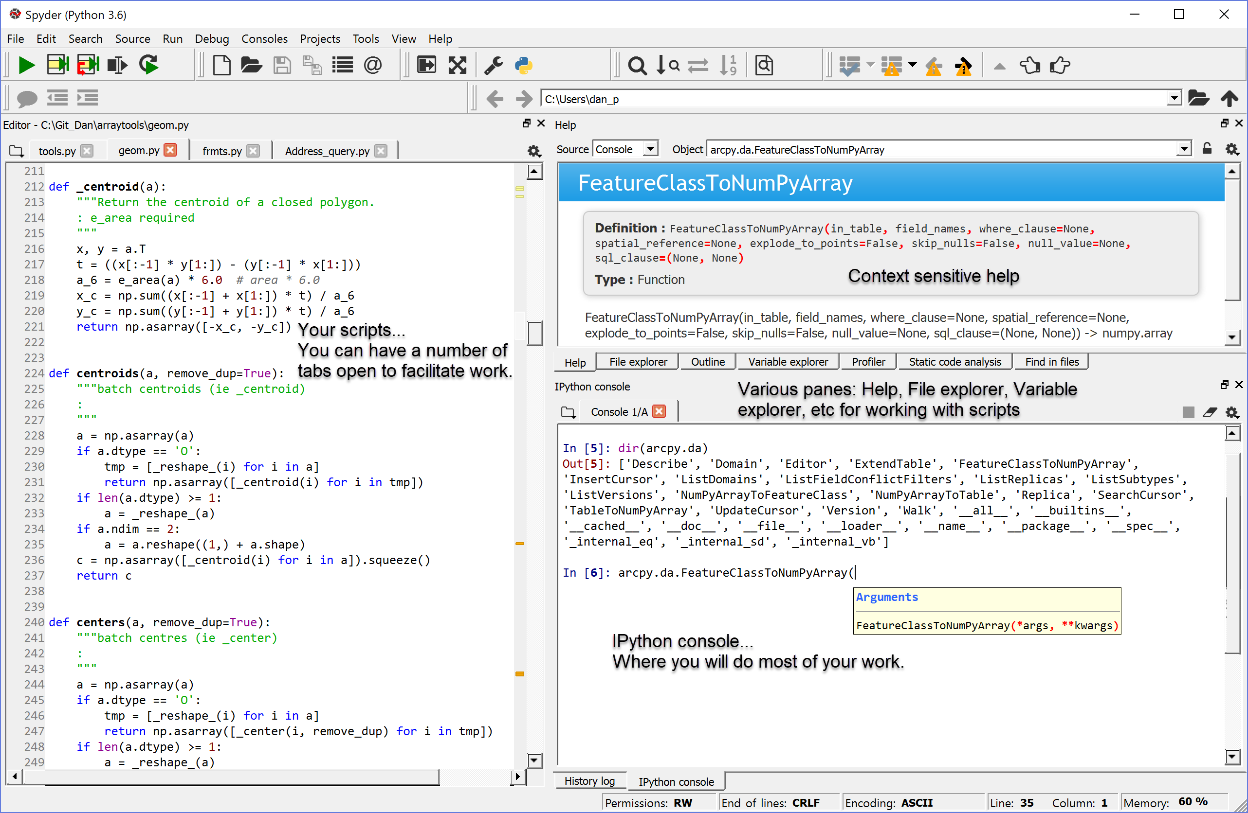

:----- The whole interface
... which can be arranged to suit

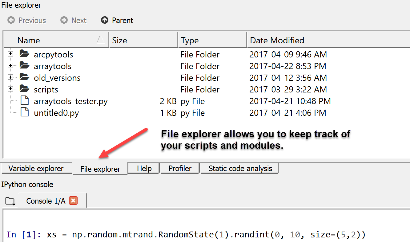

:---- Keep track of project files

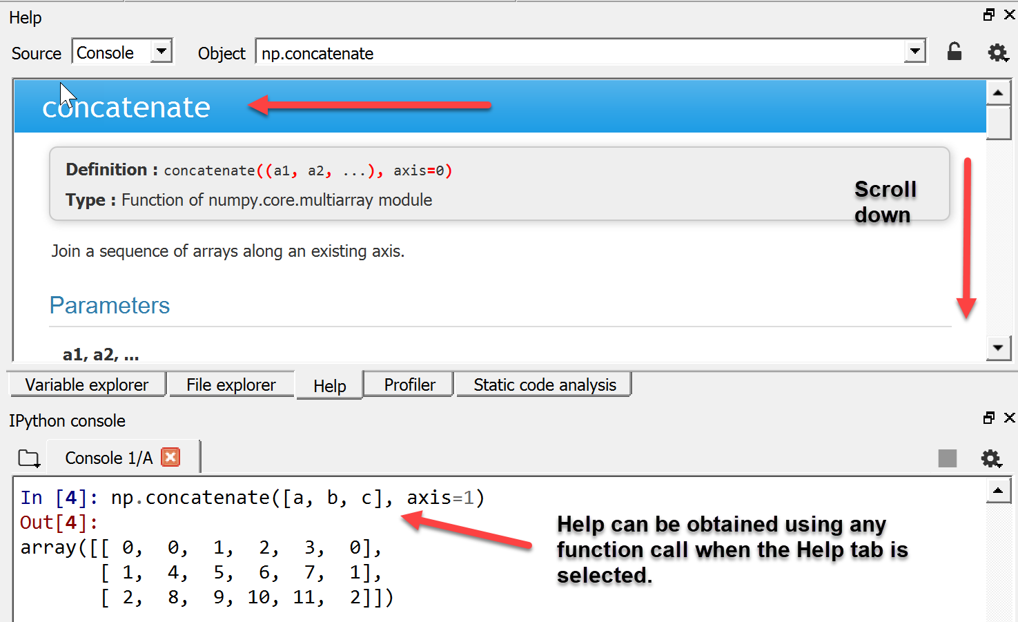

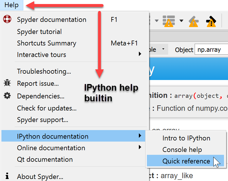

:---- Need a little help?

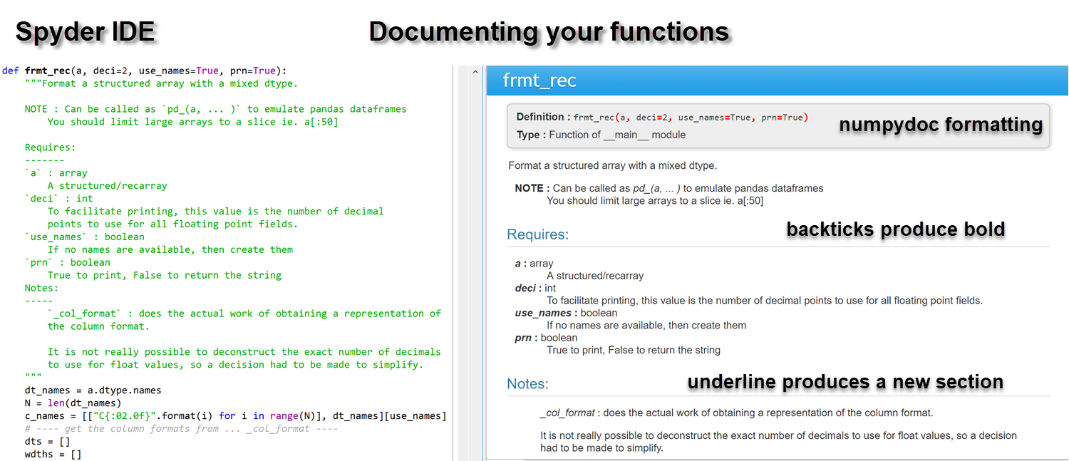

:---- Fancy documentation with minimal effort
:---- Help for IPython?
:---- Help for other Modules?

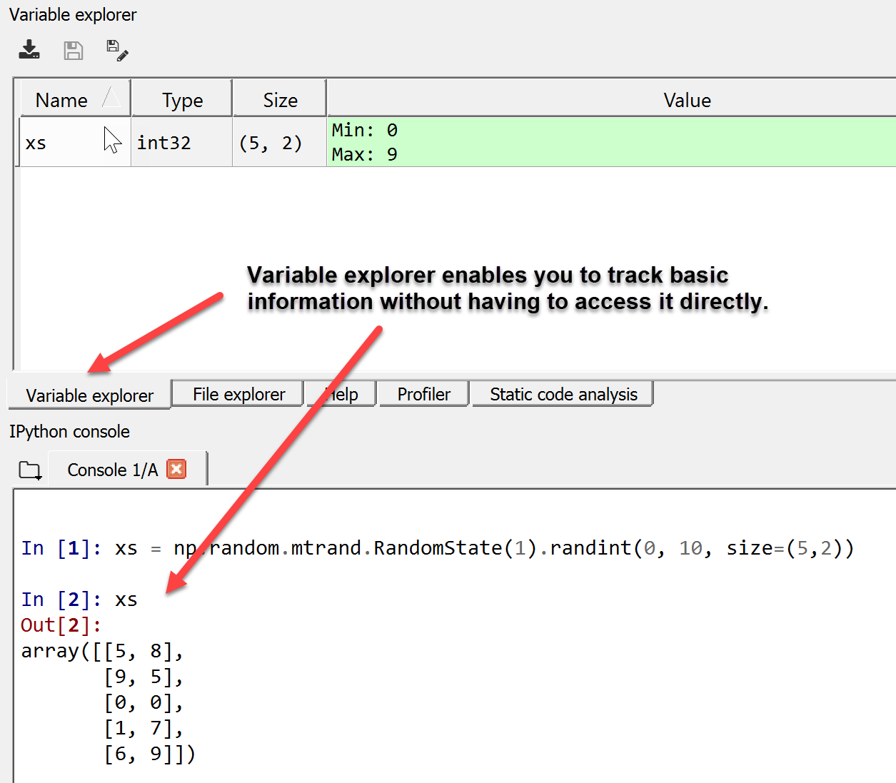

:---- Check out your variables

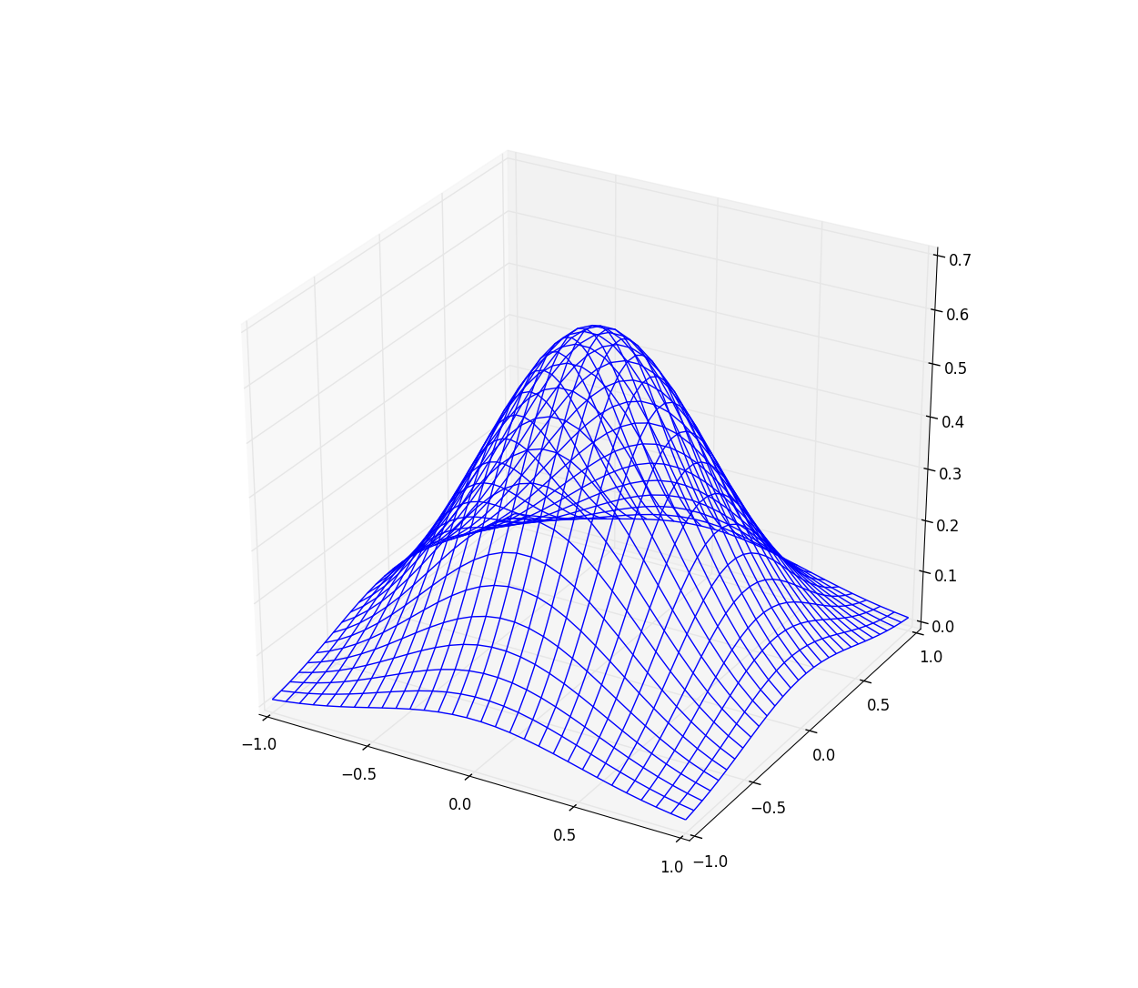

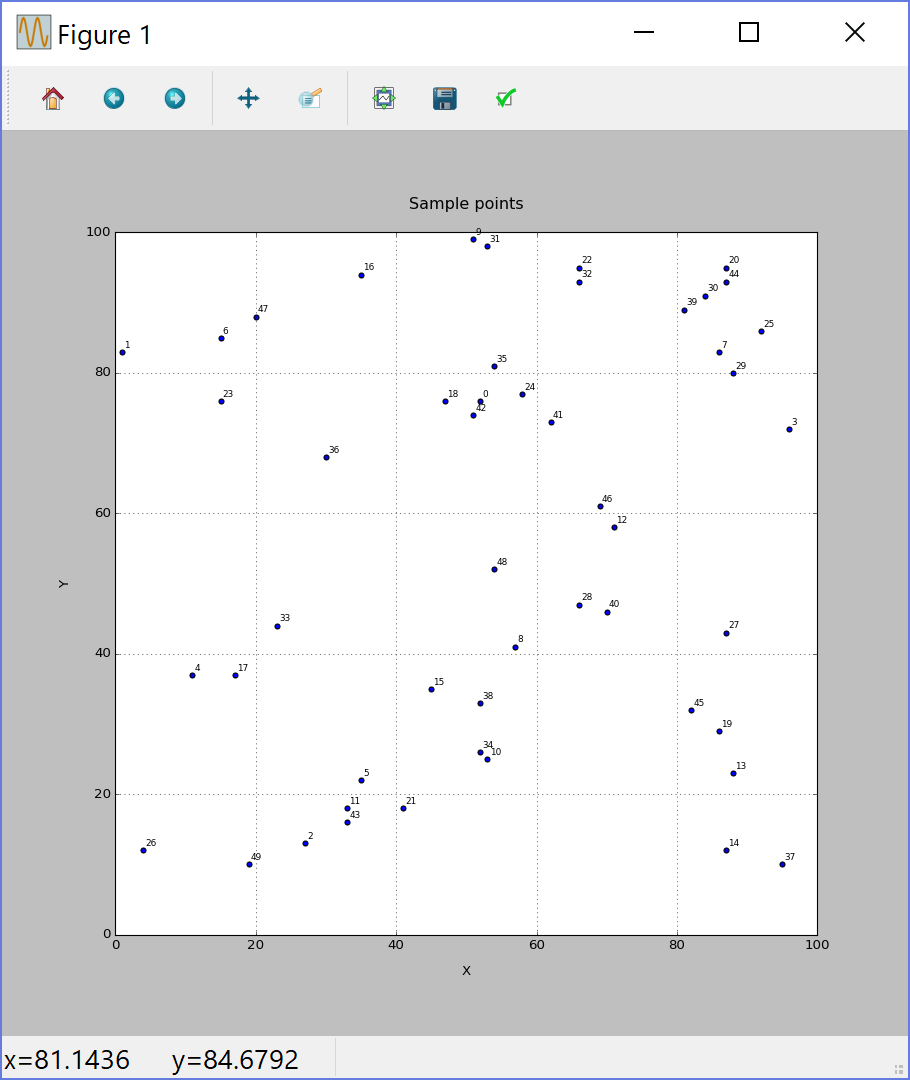

:---- Some graphs?
Yes from within Spyder, you can use Matplotlib or any other installed graphics pack (ie seaborn, orange etc)

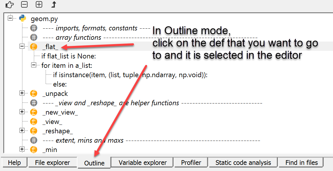

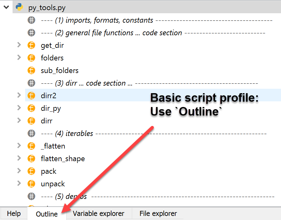

:---- See your scripts in outline mode,
Quickly navigate within them like a table of contents or use outline to get a basic shell listing of your script
The trick to outline is to use # ---- Your comment here   4 dashes seems to be the key for some reason

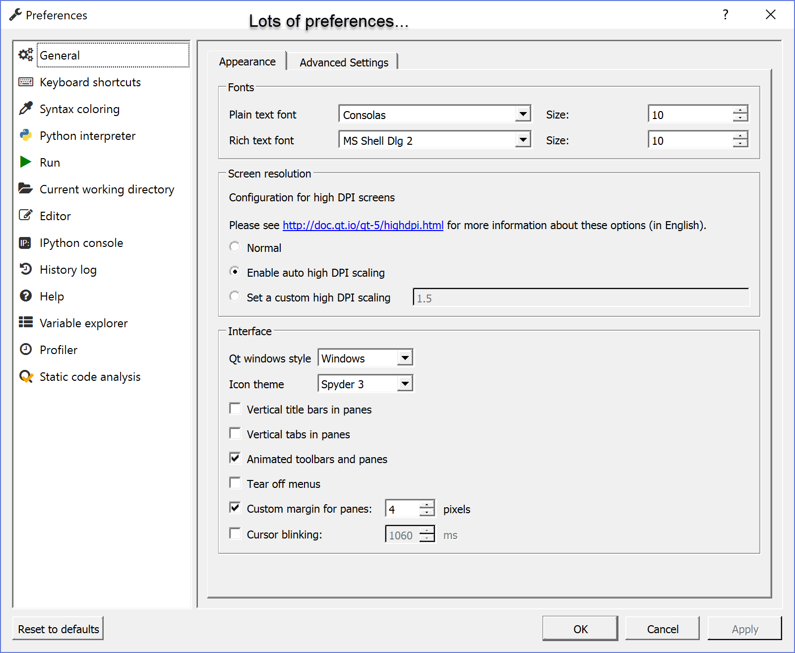

:---- Don't like something?
Change it

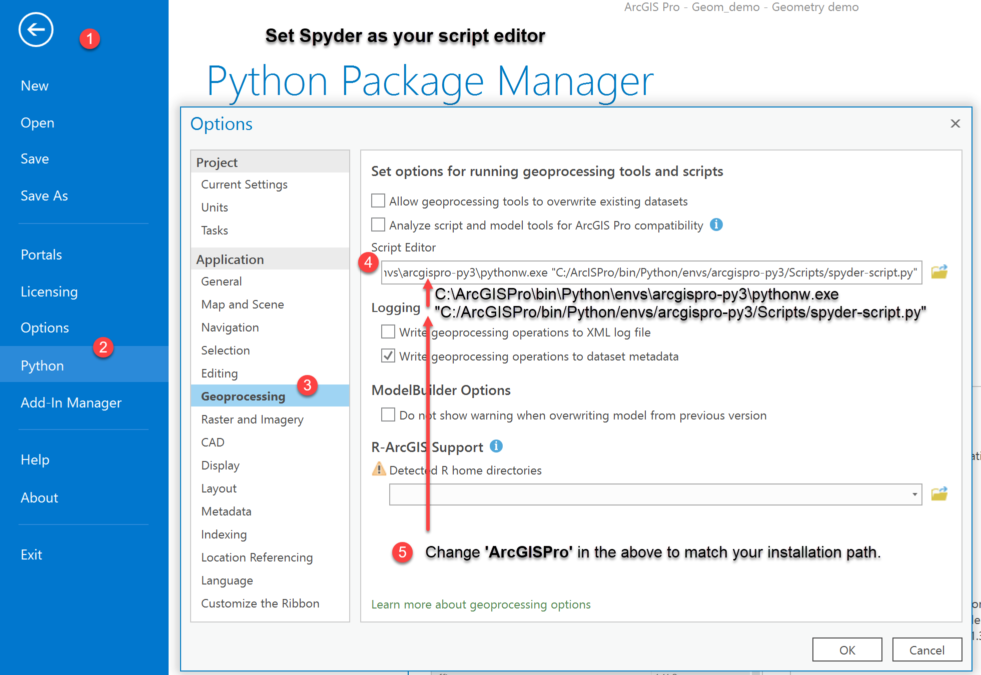

: ----  Set Spyder as your IDE for PRO
: ---- Fear not...
You can even pretty up the interface
