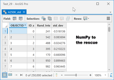

Now there are several places you can go now... How about a new table with the results???
from numpy.lib.recfunctions import append_fields
# reference : https://numpy.org/doc/stable/user/basics.rec.html
out_arr = append_fields(
    in_arr, "std_dev", stdev, fill_value=-1, usemask=False, asrecarray=False)
out_arr.dtype
dtype([('ID_s', '<i4'), ('Rand_Ints', '<i4'), ('std_dev', '<f8')])
NumPyArrayToTable(out_arr, gdb + "\\A250K_std")  # out it goes
