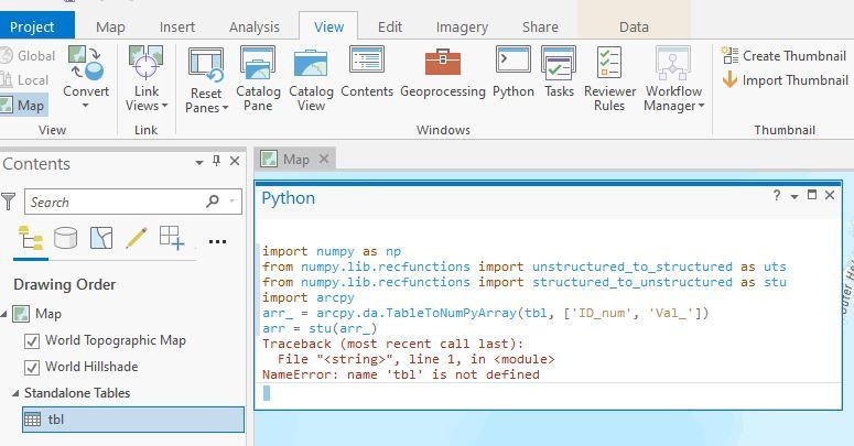

But since I have never used Arcpy before I'm completely lost on how to work with your script.
I recreated the first table "tbl" with its attributes and saved it in a gdb. But how do I  make the transition work?
I only used Modelbuilder before...this is clearly out of my comfort zone. Can you help to make it run so I can fully focus on starting with beginner arcpy stuff again? Really wanna help my friend since he never worked with python and I seem to be his last hope.

FynnScharpen
DanPatterson
MVP Esteemed Contributor
tbl .... that would be the full path to the table in your geodatabase ...
