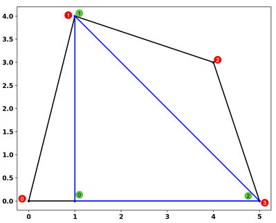

Start with two simple shapes that have common points, but this time, we are just interested in the points and not the segments.
comparison_1.pngShape 'a' is the black outline with the red point identifiers and shape 'b' has the blue outline and the green labels.
There coordinate values are:
a = np.array([[0., 0.], [1., 4.], [4., 3.], [5., 0.],[0., 0.]])
b = np.array([[1., 0.], [1., 4.], [5., 0.], [1., 0.]])
Being the quick people we are, it is obvious that they share points [1., 4.] and [5., 0.] which are pairs
[1, 1] and [3, 2] using zero-based enumeration.
So how would you find out what points are duplicates and where they are using python and numpy.  Let's break it down.
