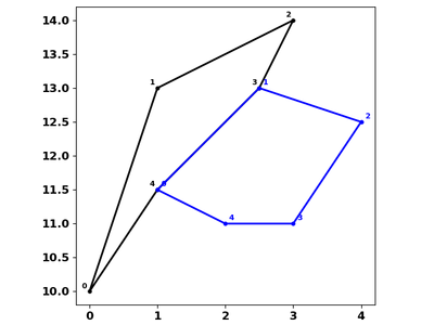

# -- Two polygons
a
array([[  0.00,  10.00],
       [  1.00,  13.00],
       [  3.00,  14.00],
       [  2.50,  13.00],
       [  1.00,  11.50],
       [  0.00,  10.00]])
b
array([[  1.00,  11.50],
       [  2.50,  13.00],
       [  4.00,  12.50],
       [  3.00,  11.00],
       [  2.00,  11.00],
       [  1.00,  11.50]])
Which look like this.

Lets break down line 18.
a[:, None] == b  # -- `a` is broadcast so that each segment can be compared to `b`
array([[[0, 0],
        [0, 0],
        [0, 0],
        [0, 0],
        [0, 0],
        [0, 0]],
       [[1, 0],  # -- one match
        [0, 1],  # -- one match
        [0, 0],
        [0, 0],
        [0, 0],
        [1, 0]],  # -- one match
       [[0, 0],
        [0, 0],
        [0, 0],
        [0, 0],
        [0, 0]],
       [[0, 0],
        [1, 1],  # -- both match --
        [0, 0],
        [0, 0],
        [0, 0],
        [0, 0]],
       [[1, 1],  # -- both match
        [0, 0],
        [0, 0],
        [0, 0],
        [0, 0],
        [1, 1]],  # -- both match
       [[0, 0],
        [0, 0],
        [0, 0],
        [0, 0],
        [0, 0],
        [0, 0]]])
# -- next ... reduce the dimensions by 1
(a[:, None] == b).all(-1)
array([[0, 0, 0, 0, 0, 0],
       [0, 0, 0, 0, 0, 0],
       [0, 0, 0, 0, 0, 0],
       [0, 1, 0, 0, 0, 0],
       [1, 0, 0, 0, 0, 1],
       [0, 0, 0, 0, 0, 0]])
# -- next ... and one again.  Note -1, means the last axis
(a[:, None] == b).all(-1).any(-1)
array([0, 0, 0, 1, 1, 0])
# -- finally, the comparison has been reduces from a 3 dimensional array, to 2D to 1D
# -- the result
np.sum((a[:, None] == b).all(-1).any(-1))
# two points which `a` meets `b` at points 3 and 4 (good old `nonzero`)
np.nonzero((a[:, None] == b).all(-1).any(-1))[0]
array([3, 4], dtype=int64)
# if we reverse `b` and `a`
np.nonzero((b[:, None] == a).all(-1).any(-1))[0]
array([0, 1, 5], dtype=int64)  # -- 0 and 5 are the start and end point of `b`
