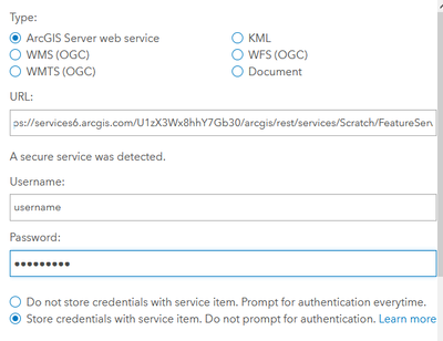

You'll want to add the item to your Contents, not just to a map. When you add an item on the Content page using the From the Web dialog, it will detect if the URL you're adding is protected.
If it is, it prompts you for a username and password, and gives you the option of storing credentials for the service.
If you opt to store the credentials, the data can be used throughout your Portal as the item-level sharing settings allow, without needing to log in to AGOL.
It's a super useful option, but the documentation is well worth a read for a few of the performance-related caveats and such.

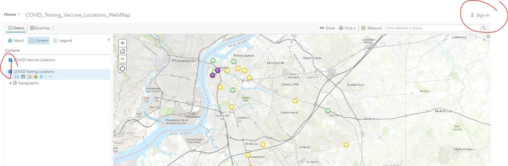

Actually Josh I have one more question for you. When I finalize the web map and make public, log out of my Enterprise account to test the link, it shows that I am able to have similar permissions to somebody who is logged in. So I am able to change symbology, as an example. Is there any way to terminate that option? The less settings/options, the better for Administration.

@KamillePretoTechnically, that sort of thing is always possible if the web map is shared publicly. What the public can't do is save any changes to the map for anyone else to see.
Sharing the map inside of a preconfigured app still doesn't prevent this sort of thing, but does put the map options a step removed from the viewer. Even if you just wrap it up in the "Minimalist" viewer or something, that's usually enough to make your map accessible to the public without showing them all the controls.

That makes so much sense, thank you so much Josh. I am more used to producing Web Applications & Dashboards, not usually Web Maps so I think it's just been a while since I have seen the interface of one.
