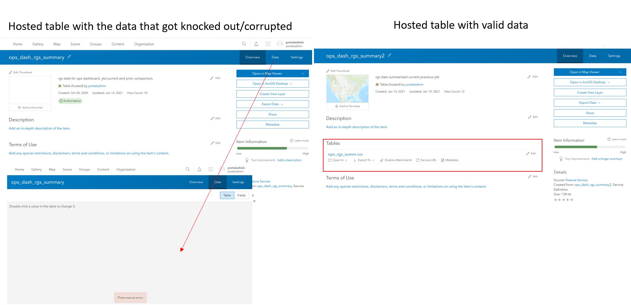

I have 6 hosted tables in my Portal that are used in various dashboards and maps. These are updated each day via a python program. At some point in the overwrite process something happens that knocks out my data source and the data no longer exists for that specific hosted table. I see the layer in my portal but when I go to its details page there is no data in the data tab -- instead it only says "There was an error". (See side by side of hosted table that has been corrupted and a valid table below)
If this happens I can no longer overwrite the service anymore. It remains visible as a selection in my portal layers, but when I choose the table to overwrite it comes back with the error, "Unable to retrieve information for the existing item." I have to delete the table and service definition in portal and then re-publish. Then I can again successfully overwrite on this new table. The loss of the table also obviously affects my dashboards and maps too. (Error seen when I try to overwrite through ArcGIS Pro, below).
